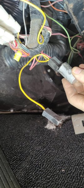

This single-spade yellow wire hanging off what I believe is the delay-relay, with yellow and pink wires...what might this connect to, if anything?

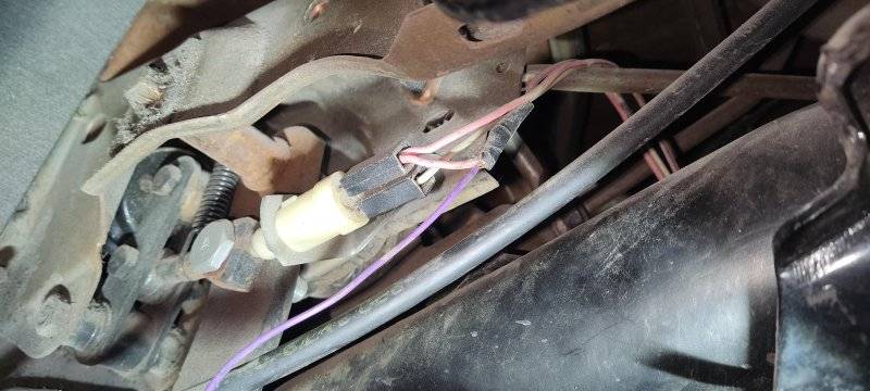

And lastly, this purple wire hanging loose from the brake switch, where it was spliced into one of the pink wires. This definitely doesn't look original. Any clues what it might've been used for, and more importantly, is it no longer needed, for a car with now-all-original wiring?
Find out where the violet colored wire goes "last picture" I bet it goes into the driver side kick panel and into the connector that feeds the tail lights. Its either a bypass wire to bypass something that was not working or they needed to use the brake pedal to trigger something.

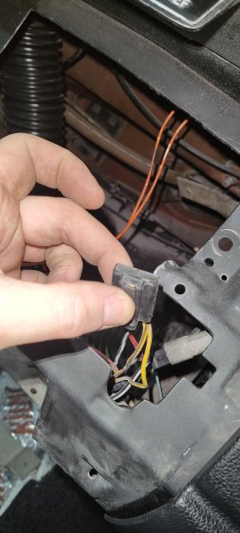

The second photo is the harness for the ign switch light. Yellow is a ground circuit? They all get plugged inline on the way to the door switch.
That wire just hangs down and there's a blue tube wire connector on the end of it. I'll need to take a closer look there but I've already reconnected everything with the wiring at the kick panel and didn't see any loose wires.
I didn't notice any empty spades at the wiring at the kick panel, but I'll take a closer look. Seems odd that yellow would be a ground... :)

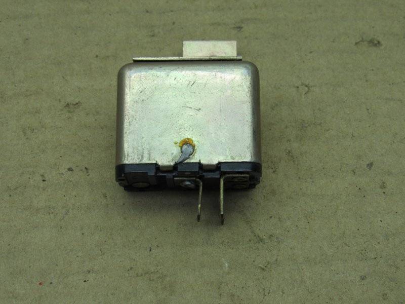

This 3-spade connector with parallel-aligned spades has no mate anywhere. Looking at the yellow, yellow w/brown tracer, red and grey (?) wires, does anybody know what this might've been used for?
The three terminal connector is for the key-in buzzer. The following image shows an example of the buzzer:
For the time delay wiring, pink is the power feed, yellow with tracer is the door switch feed(s), and yellow is the feed to the ignition switch lamp. For 1970, there should be a yellow wire with bullet connector going to the column for the column mounted switch lamp. The spade terminal was used in 1969 for the dash mounted switch. It looks like it is connected with the other yellow wire, but if it has a tracer on the other side and is connected with the other yellow with tracer, it is for connecting into the door switch wiring. It does not appear in the 1970 Charger service manual.
The purple wire is not original and has been spliced into the pink wire. The pink wire is powered all the time, so it was likely added as a full time power tap, perhaps for the removed security system.
Awesome Vaanth, thank you. I figured that purple wire might've been for the old alarm system.
I'll have a closer look at my steering column for anything related to the yellow wire, but I have a feeling it's a remnant from a 1969 dash harness and doesn't do anything with the 1970.
