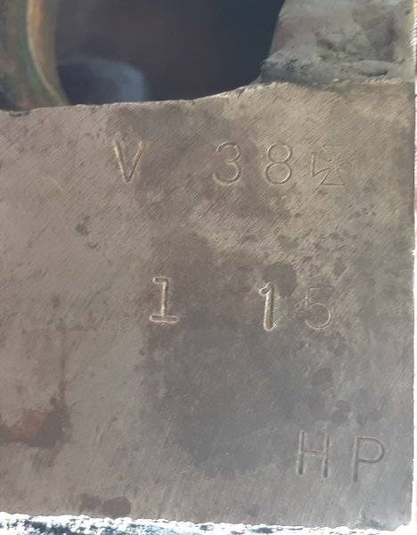

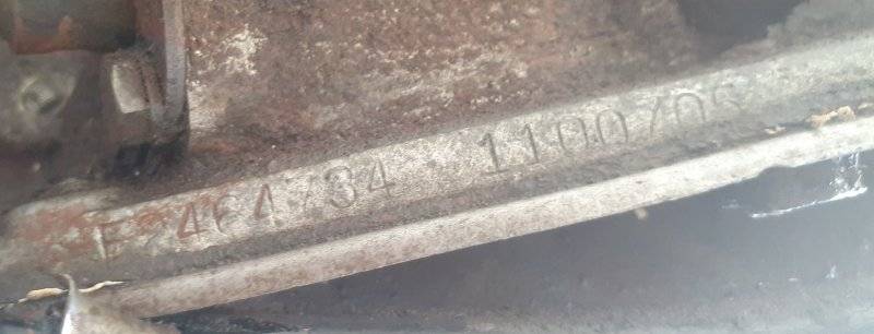

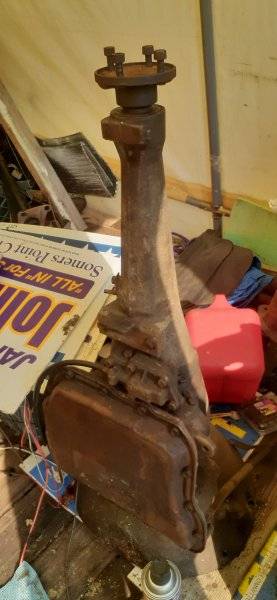

It's supposed to be from a 64 Sport Fury
383 and console cable shift 727

V=64’ 1-15 of 64’ is the assembly date. I’d say the chances are very high that is from a sport fury.
How about the number 38, has a maltese cross stamped to the right of it. It also have HP stamped on the bottom right of the pad.
I'm really interested in learning about the transmission. I plan on putting it in a 65 Coronet with a console. I know the 65 has a slip yoke. I'm reading that you can get parts to make a slip yoke driveshaft for the 64 transmission as opposed to swapping the output shaft to a slip yoke.
