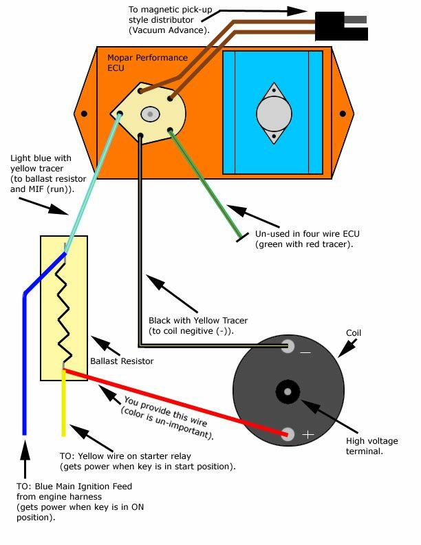

Are you running a points distributor or an electronic ignition with an ecu?
More Information is needed . So your stating cranks but won't start?? No spark?
something simple did you check & see make the distributor shaft is turning?
electronic distributor has a reluctor gap correct?.. poor ground for ECU, broke wire...
1. Ballast Resistor
2. Coil-A coil needs only two things to spark, voltage and ground.
3. Electronic Control Module
4. Voltage Regulator
5. Starter Relay
Here's some easy steps to check the ignition system....
Chrysler Electronic Ignition System

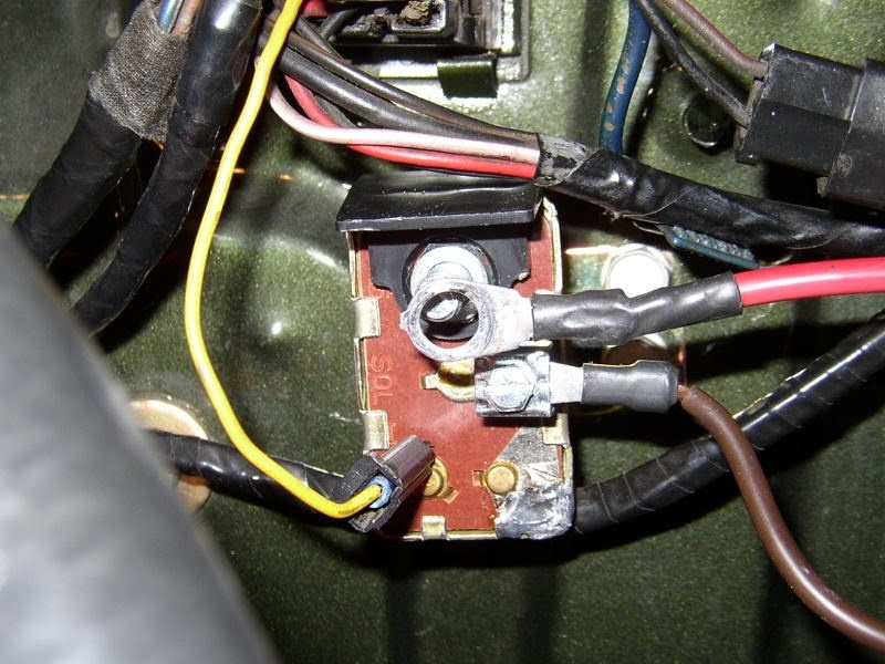

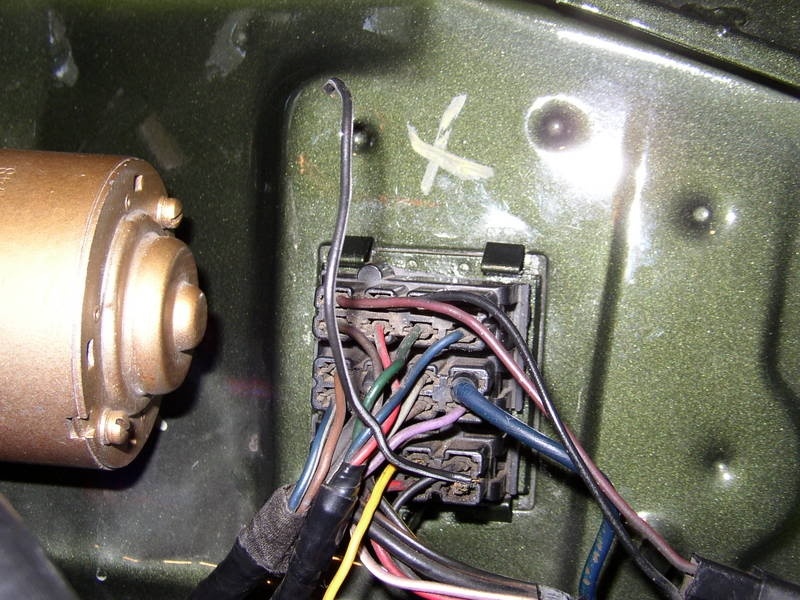

ok i found bad splice in wire from firewall wire harness to starter relay its the bottom corner wire harness and if connection is good its hot . the pics are not of my car just examples can this be causing no start.
