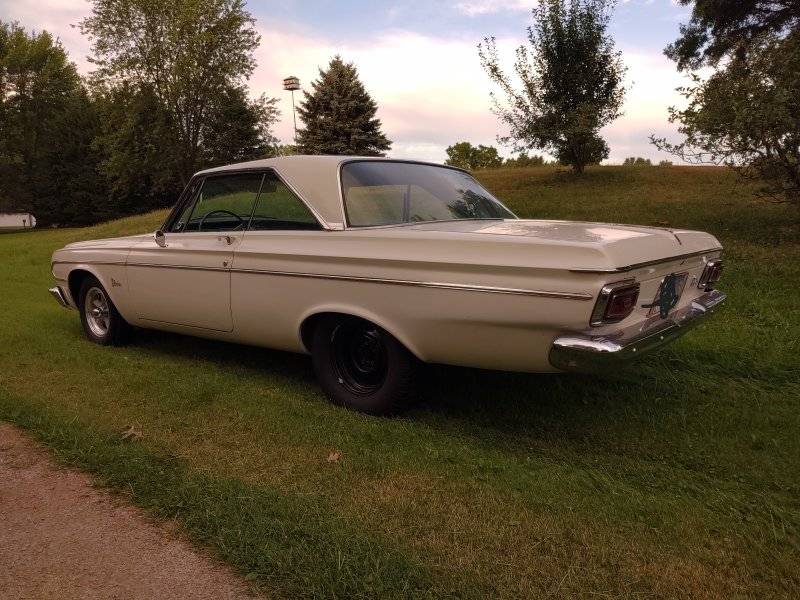

Help with leaf spring choice. Pictures inside!

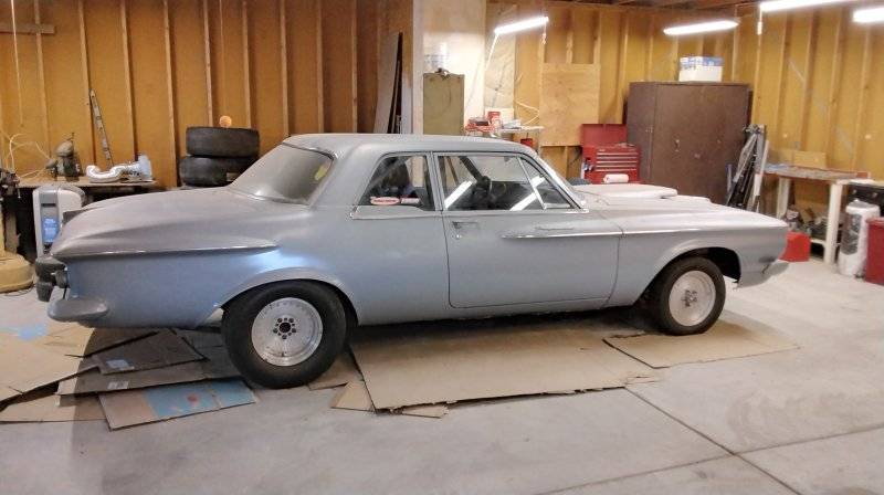

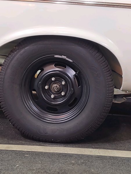

This is my ride height.

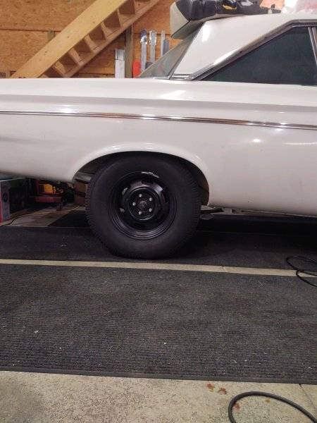

1965 Factory b- body has a 21" front segment. 66 and up 22"front segment. This can be juggled some but keep in mind Plymouth and dodge used different length front hangars.
Here is my ride height with 456/457 superstock springs, about a half inch higher on the pass side than drivers. With 10x28 or 10.5x28 slicks.
I don't know if I would recommend the current ss springs, I have heard of them sagging fairly quickly. These are the Mexican built ones, and have been on the car for at least 20 years.
Mancini sells the current versions of these for under $150 each, but you will probably need the hangers that go with them.
Nismobishi

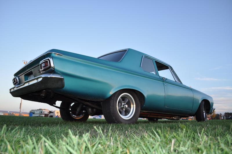

Here you Go.

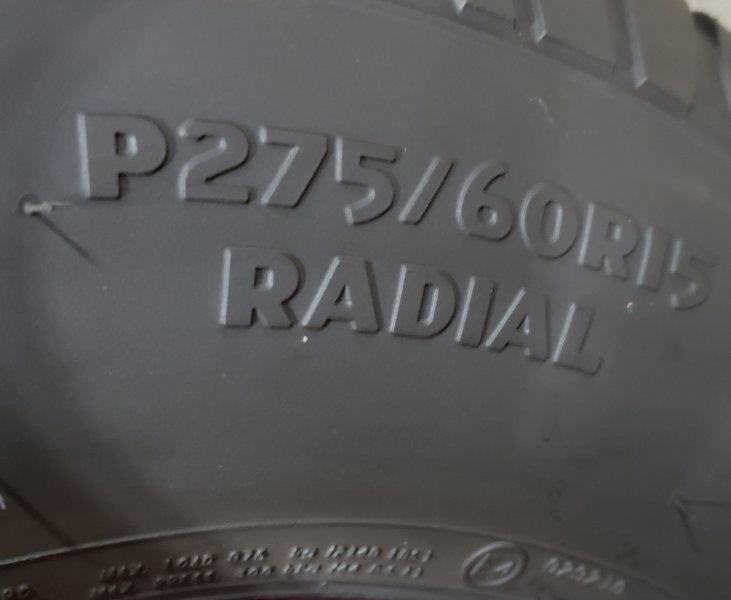

I did allot research from this board to get the right tire/ rim BS to get the look for my car. MT sportsman tires.
I wanted to go with pie tin tires but the old style non radials are tuff to deal with.
Rims
front 15" x 5 4.5 BS
Rear 15" x 7 4.5 BS

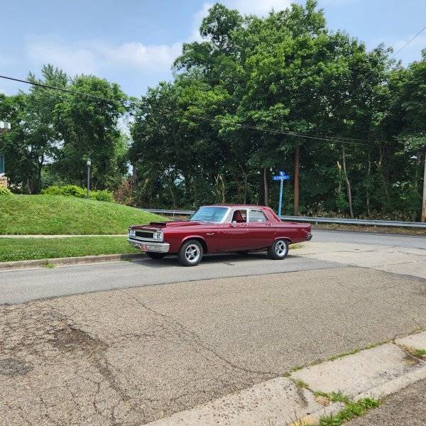

You might also check with St. Louis Spring Co. I haven't purchased from them for many years, but when I did, they would make whatever you want. I had the ones for my '64 Belvedere made with an extra leaf and 2" extra arch. That put the rear end much higher than what you want. I would think that 1" extra arch would give you what you desire.

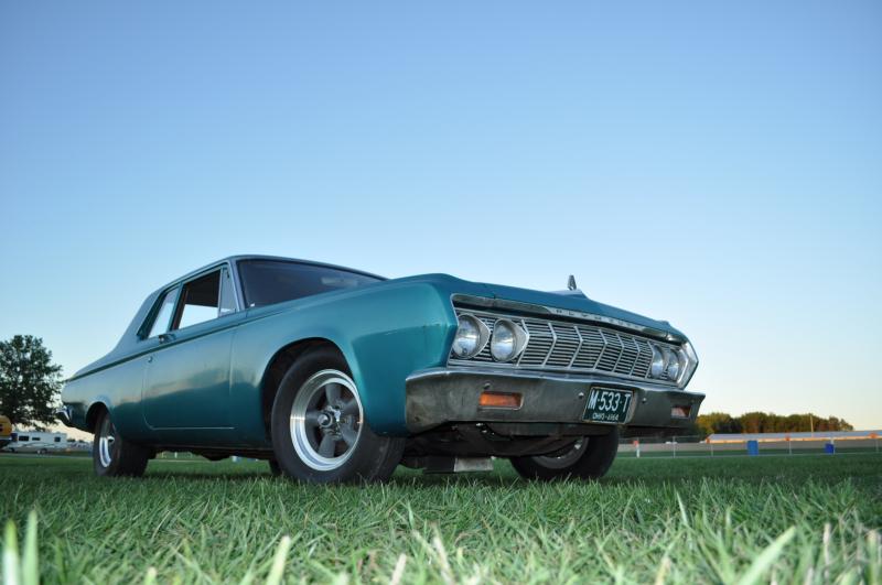

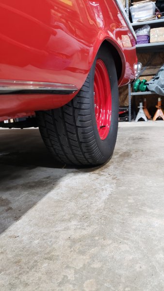

Heres the same car today, with Espo std rating +2" springs
