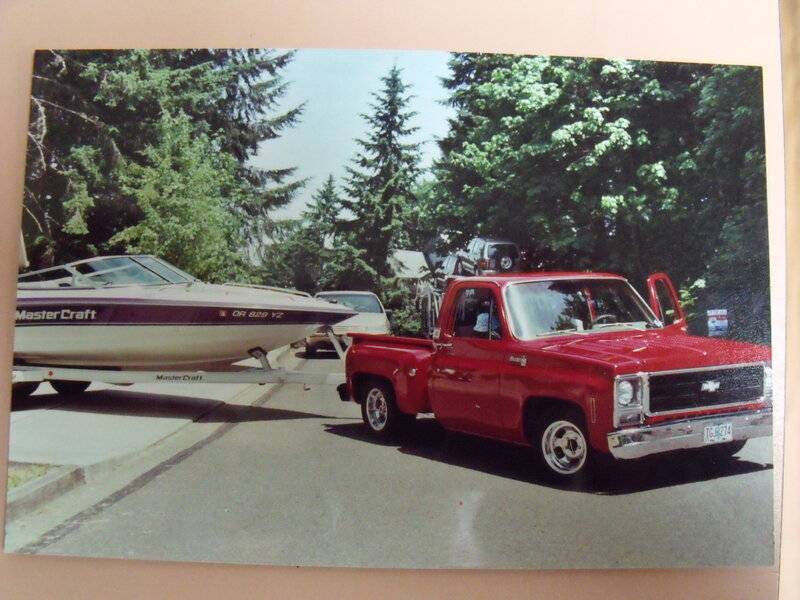

I chased low voltage in this truck I did a "frame off" resto on right after I got it running.. Finally a small parts store did a cell by cell test on the NEW battery and found it had a bad cell ( Exide) .. Even on this antique, having the correct voltage made the Dash lights much brighter and the stereo worked better too.....
