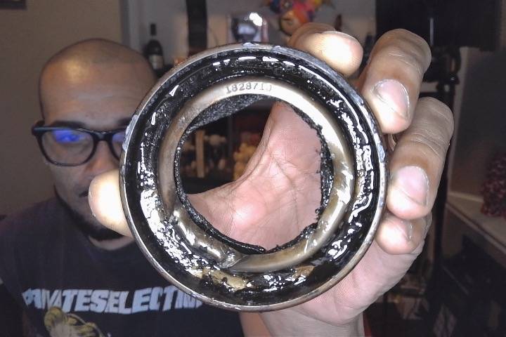

Finally getting around to changing this leaky rear pinion seal and after a tough fight, I finally got it removed. The original one was still in place with a part number showing 1828719. Went to Oreilly to get a replacement and they gave me this. https://www.oreillyauto.com/detail/...automotive-car-1969-plymouth-roadrunner?pos=0
Obviously not the same thing as this new one doesn't even seal anything. What am I missing here???? Does oreilly or autozone sell a proper replacement or do I just need to ebay a NOS one with the same part number as the one that came out???

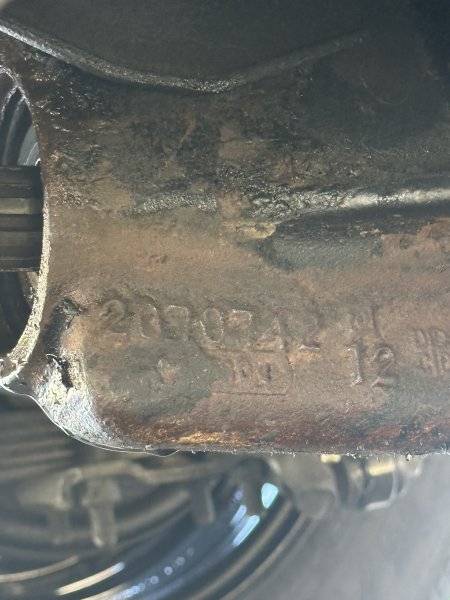

That style of seal in the link is common now. You need to specify what rear end housing you have. Can't go by the book so much because our cars had parts swapped around for the last 45 years or so. On the side of the housing you will have a large casting number ending with 741, 742 or 489. I believe the pinion seal is unique to each of them. As a rough guide as to what year goes with what third member, the 741 is 1967 and older, 742 is 1968 and probably early 69, the 489 is 1969 and up.
The book doesn't know the housing numbers, they go by the pinion size:
741 is 1 3/8
742 is 1 3/4
489 is 1 7/8
A little hard to tell but I'm gonna go with 742 here....
