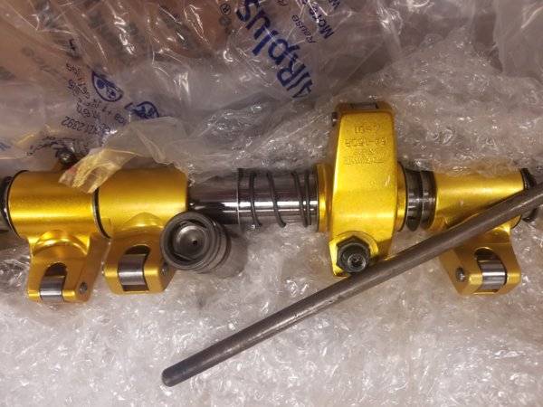

The rocker assys that came with my motor are too worn.
A few months ago I brought a good set of crane gold rocker assys from a member here.
They will not work with the pushrods I have. The new rockers are the adjustable type and need pushrods with cupped upper ends.They current pushrods are 5/16" diameter x 9.25ish in length.
Any advice or links would be appreciated.
It would appear as though I need 9.25" x 5/16 pushrods with cupped ends.
Or will 3/8 work as well?

Which size motor? B or RB? My opinion, go with the chrome moly 3/8" in case you up size the cam/springs. A good idea to double check with lifter manufacturer, seems like the height may vary a bit. Different manufacturers measure the length differently, so using a pushrod checker will give the tip to cup length.
I have a new set of crane cup/ball push rods for a hydraulic cam RB block if needed. I use smith bros. for custom rods but you need to know how to measure for them. details on your cam and heads would help, and why are you are going to adjustable rockers? just trying to make sure your not spending money that you don't need to. those gold rockers will most likely increase rocker ratio that may have a negative effect on valve springs and seals.

I'm going with the adjustable rockers cuz they're what I have and I scored them on the cheap.
They're like brand new.
I just got some comp pushrods ball/cup today that arr the same length as the ones theyre meant to replace and have some slightly shorter ones coming in a few. So between the sets one should work

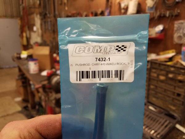

Or some shorter pushrods. Comp Adj. Cup/ball.
