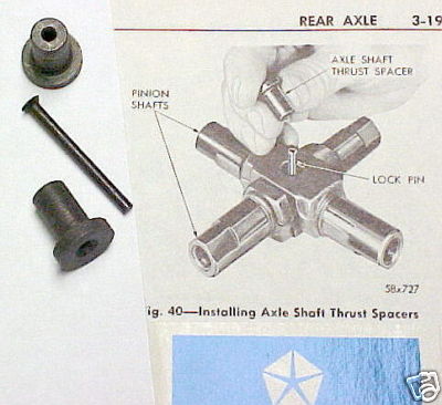

Isn't the center thrust pins shorter in the older rears that used the tapered axles? I know the 41, 42 and 89's are all the same as far as that goes....
That I'm not sure as the last one I had, had the clutch type suregrip in it with this type

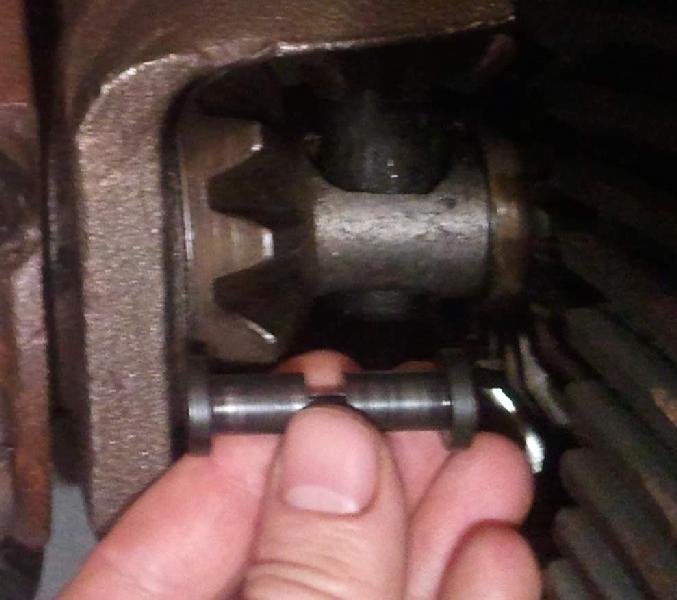

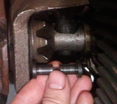

Oh now I see what you mean... the SG thust pin vs the thrust pin in an open center...
I dont have an open thrust button out of a case at the moment so I cant effectively measure one and the one I have from a SG I really cant measure because its out! lololol
Even tho the thrust pins are different looking between the SG and open units, they are pretty much the same length in the 'modern day' rears....but I'm told the ones in the older axles using the tapered axles with the nutted on drums are shorter.
