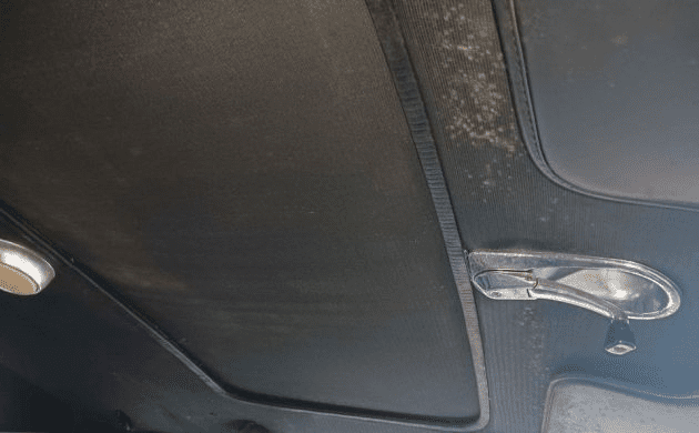

Can someone tell me if it’s supposed to be sheet metal or fiberboard? The one that was shoved up there was fiberboard and not attached to the sunroof.
That looks OK.
I sold my sunroof roof a few years ago, but there was remnants of similar material on mine.
It's affixed to the outside (IIRC)) of the moving assembly, possibly with glue.

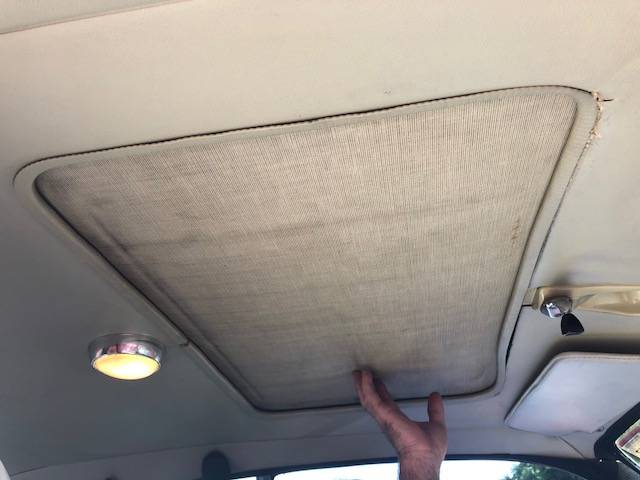

From what I can see there is a panel that attaches to the moving sunroof on the bottom. I believe it was covered in fabric and attached. Was it made of metal or fiberboard? The one in the pic is for reference, it’s not mine. I’m trying to install a new one and I have no idea what it’s made of and how it attached. I think I found a post from the A body forum that shows it clips on like a door panel. Now I need to know what it was made of so I can fabricate a new one. It seems like fiberboard would be too flimsy and not stay in place when clipped over the the thumb roller adjustment brackets. I was thinking it was originally sheet metal. There was one in the car when I bought the car. It is a piece of fiberboard wrapped in the same fabric as the headliner and not attached to anything. They just shoved it up in the hole. The sunroof didn’t work. We pulled out the sunroof and frame and rebuilt everything. Now we are trying to figure out how the panel goes in. It needs the panel to hide the bottom of the sunroof and finish off the inside roof of the car, but we have no idea how that was accomplished from the factory so we can duplicate it.

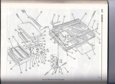

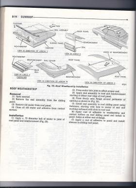

I need to get this in a readable enlarged version. Does anyone have these they could email me a pdf? My service manual does not have them.
