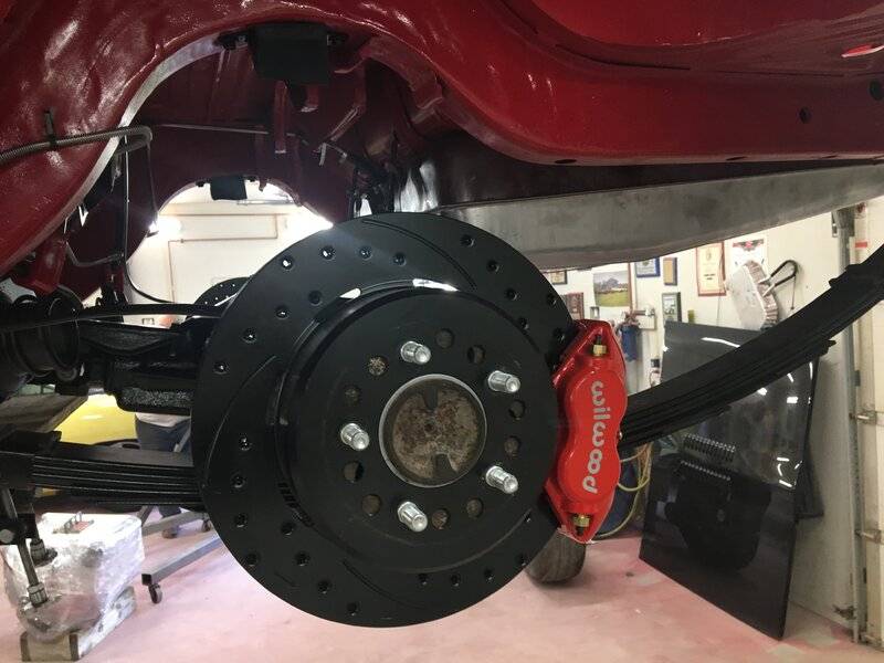

I am in the process of changing my old school cragars over to the Mopar steel wheels - fronts 15x8 and the rears 15x10. I have a Wilwood disc brake conversion front and rear ( installed prior to my purchase). The rear 15x10 rear wheel with 5.5 backspacing hits the Wilwood caliper in the rears - literally 3/16 of an inch on top and bottom. We cannot use spacers because the tire width ( 50 series) will hit the 1/4 panel lip if pushed out any further and the calipers cannot be modified. I have 12.19 sized rotors in rear. I cant use the 11" Wilwood rotor kit without replacing the entire set up in the rear. Has anyone got a fix for this from their own experience or should I go back to the rear drum set up as originally planned before the steel wheel concern? Thank you for your help

3/16”? Sounds like a little off the top with a grinder can fix that
That’s the only thing I can think of without using spacers
Slot the caliper mounting holes to make the caliper hug the rotor?

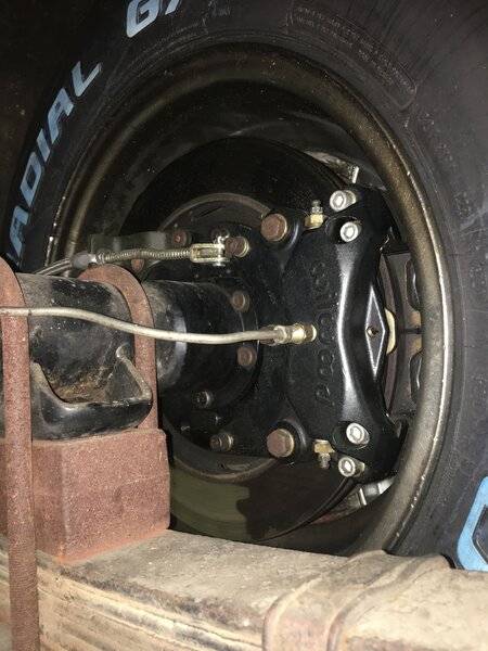

I’ve got the exact same kit as you and I am running 15” wheels on the back of mine. I’ve got a 4.75” backspace also 15x10... mine are American racing 200s... I had them built to clear these callipers though. Was a bit expensive. But nonetheless it’s on and it works without a spacer. I have 28x12 Mickey Thompson tires. Maybe you can take your wheels to a wheel shop and have them modified to fit? Up here costs about $300/wheel for something like that.

Hemiphant: Is that a hard line going to the caliper? If so how do you remove the caliper to remove a rotor etc without opening up the brake system and having to bleed the brakes?
