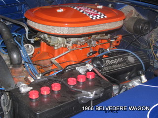

Let's see...production tolerance can stack up against you....timing gears mismatched in the same box and the dots flat out punched in the wrong spot....and how bout the cam being ground off of center. Man, I don't mean to be sarcastic but all of this can and has happened. A buddy that builds engines for a living got in a hurry on his own engine and installed a new 590 lift cam by the dot method and bent all 8 of his brand new 2.14 intake valves. Installing by the dot method leaves you scratching your head when it won't start or run right. Using a degree wheel will tell you EXACTLY where it's at and gets rid of the guessing game. You can also set up true TDC on your balancer or at least make sure it's marked right. I've been a machinist for nearly 30 years and have seen a lot of crap happen. There's always a better way to do something and using a degree wheel is the better way. Btw, my buddy's engine actually started up but that's all it did. It would die as soon as he hit the throttle. You can at least see if it's close by baring the engine over while watching your valves on #1 with the vc off so long as the balancer is close. I've seen plenty of them slip the outer ring.
