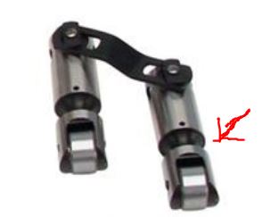

Really think it is the lifters. OP didn't say hyd or solid lifters or if lifter bores were bushed. I'd pull intake and valley cover have someone priming the engine while OP turning and watch lifters. Lifters have a (I bet) groove cut around them. The ring come out of bores and lose oil. A groove see arrow.
comp lifter have a slight none machined area in the center like this but not to this estreame
