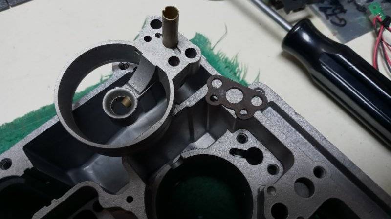

Here is a hemi secondary venturi. Just the main pickup tube. Notice the discharge port on the wall of the venturi way off center. With the large pickup hole on the opposite side. The smaller hole is actually covered by a lack of transfer hole in body of the carb. Also as I stated earlier it is a separate circuit from the main, so it does not act as an air bleed one main is on. They are not connected. Plus only one venturi on the rear hemi has the discharge. They other does not. Solid. Again distribution issues. The front does have it on both.
I have made it a hobby to study the AFB especially Hemi. So I am not speculating. You may have tuned but did you test on a dyno and measure AF ratio cylinder to cylinder. Chrsyler did. It was all about distribution improvements as they moved from 66 to 71. Also, 68-71 are different. They are AFBs that actually have a secondary idle circuit. Rear carb only.
