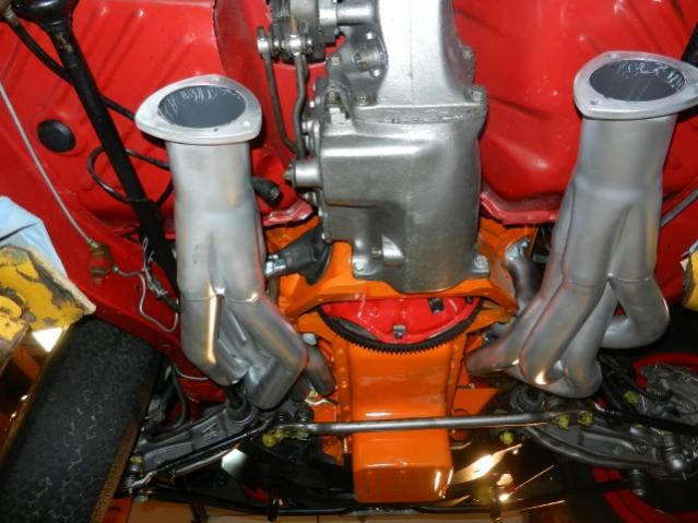

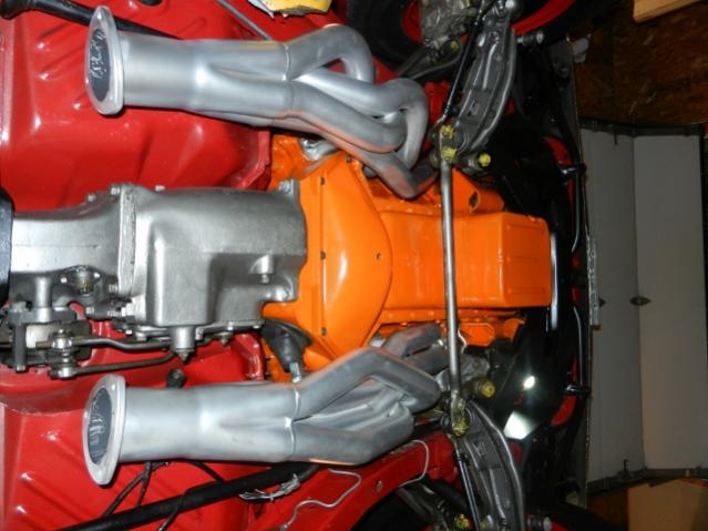

'67 Dodge R/T, tti with a few tweaks.....3 1/2 collectors ...no problem with starter :eusa_pray:
hope this helps...
Sonny
