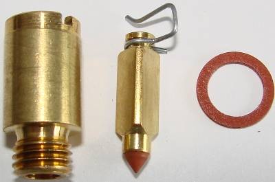

This is a real long shot on the carb flooding but do your needles have the little spring wire connectors that hook on to the float arm, the apparent purpose being for the dropping float to dislodge the needle from the seat in case it’s sticky.
If those clips hold the float too tight it will smetimes prevent the needle from self-centering when the float is closing it, causing the carb bowl to fill with fuel and run out the vents. It happened to me 2 or 3 times before I figured it out. They need to be a loose fit.

I finally took both carburetors and hooked them to a fuel line on an outdoor workbench. Using a small bottle hooked to the fuel line and filled them up. Found both needle valves leaking.
Never seen an AVS or AFB leak fuel out of the bowl. The fuel evaporates plain and simple. Two fixes; electric pump ; or fill the bowls thru the vents with a squirt bottle of fuel. The flooding is a seperate issue. Either the needle isn't seating. The seat is loose in the carb. The float is misadjusted or heavy with fuel. The fuel pressure is to high.
