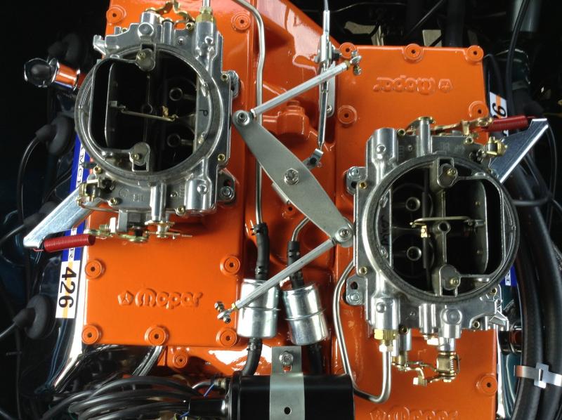

got the carb hat last week. started looking at the linkage set up and don't like the way the Hemi cross ram return spring is set up with the AFB's. One spring pulls the linkage which pulls both throttle shaft arms back. I really like the Max wedge set up, where each carb has its own return spring attached it's own bracket and the butterfly shaft arm. I ordered a new setup from Ray Barton this morning. Should be here by Wednesday. With this set up I can completely take the linkage out of play when setting the air flow, idle points and the mixture.

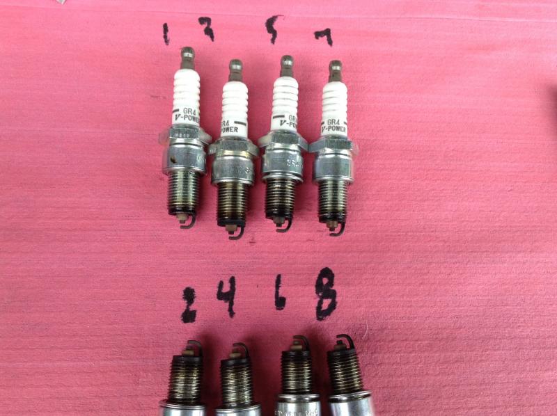

Well I took today off and yesterday my cross ram setup came from ray Barton. I only used the return springs and brackets. If anybody wants to buy the bell crank, linkage rods and cable bracket pm me. Anyway, checked for leaks, set the flow, reset the mixture screws and reset the timing. Idles right around 1050-1100.
Couple pictures and a vid link.
