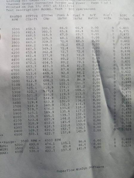

PRH is correct. Here’s a 430 cube hemi with the Victor head. I think the Eddy MP head or SR head would have been a better combo.
