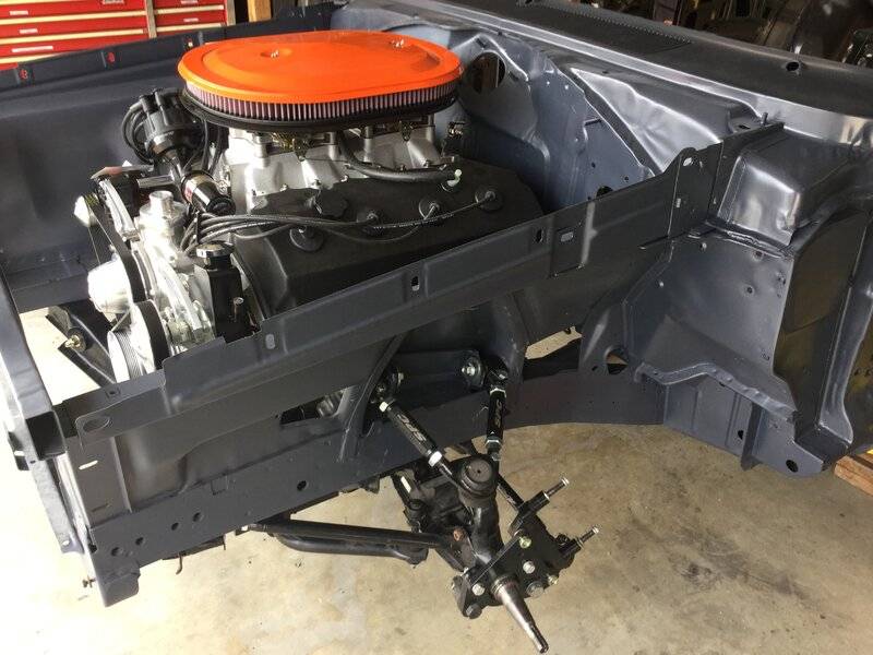

U can see the spacers now and how tall the front of the motor is in carRunning 2 carbs and have not run the motor yetView attachment 1113249
That's a sexy pic and is going to be one bad *** ride when doneRunning 2 carbs and have not run the motor yetView attachment 1113249
