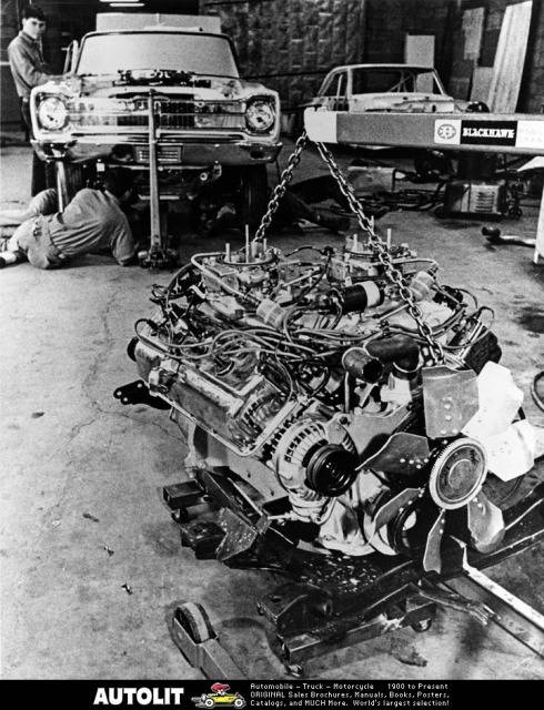

Here's a 65 Belvedere II with the 440 installed. Schumacher engine mounts, stock exhaust manifolds, and tti dual exhaust make it a fairly straight forward install.
There was a guy over on FABO had a small block in something.....some kinda A body. He took some early Hemi valve covers and made brackets and bolted them on top of the small block valve covers. I know.....it sounds redneck as all hell, but he actually did a good job on it and it turned out looking much better than you'd think. I was actually impressed.

Yep, it's called an A990 car.
