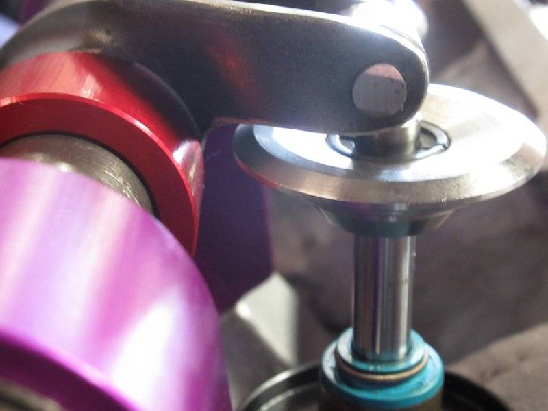

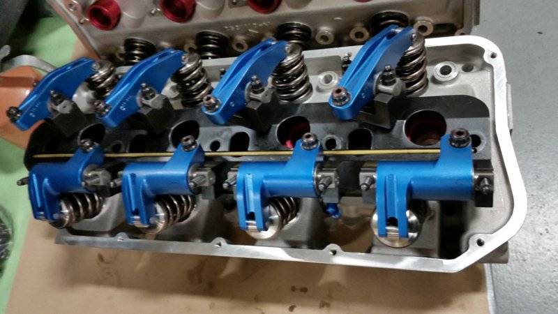

I see you guys do not use the springs. I see red clams? Does it keep the rocker more stable? Are they a must?
I think they are up to like $3250.00 now. I am W.D. with T&D and tried to go direct for a larger ratio. Nope, proprietary to RBRE''s only.
The clamps just keep them tighter so they can't move around as much.On the wedge engines they have different size shims to keep them from moving around and mine still have shims to help locate the rocker as well.

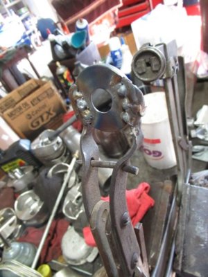

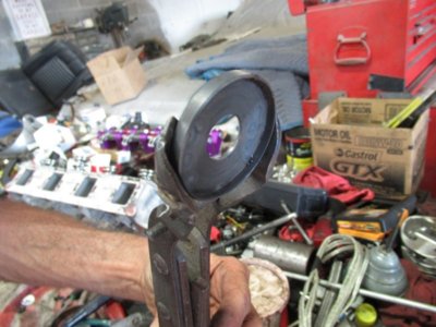

We also had ti weld a retainer to the old spring compressor to keep it from distorting when installing the springs:lol:

We make the purple ones in house. I usually only sell to holesellers. The sets I’m bringing have a marks on them. Functionality they are good the blue ones have the greedy mopar markup. I don’t know who makes the blue ones
Who make the red rocker stops? (clamps? holders?) Not sure what they are called.
I see the purple rockers stands but not purple rocker stop (holders) Just red ones
You can get them in either color.
Purple ones are made in Wisconsin USA
Hope your the only one making the purple,be nice to know they they came from you and made in the UNITED STATES!!!
I haven’t seen a purple set that we haven’t made. With ours you can bolt them on the heads with shafts on them and slide the shafts out without unbolting the stands. They are made on a 4th axis CNC Mill
