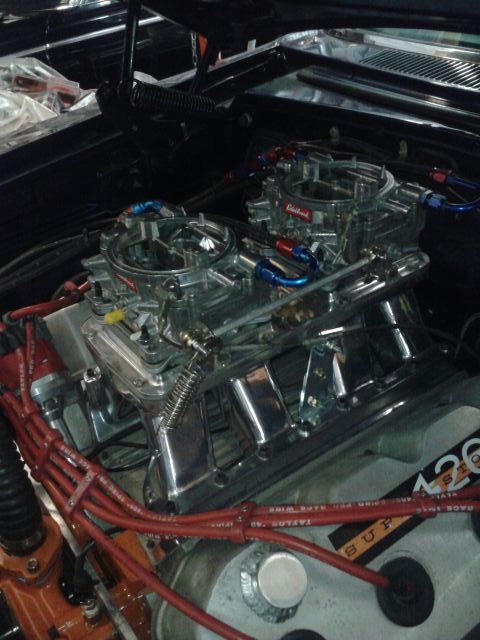

heres the final picture of the setup.
this was a tunnelram designed for 2 dominators which had 2 open tops no 4 hole openings which i retapped the pattern for 2 edelbrock carbs.

running .113 jets squared, 6948 metering rods and orange metering springs
well it looks pretty anyway...
Looks great Chris,
