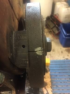

I'd be damned if I hadn't checked the timing issue, but I put it through the scope a couple of times to find some answers. What I did forget though, was that when I lined up the gears, the timing mark at the harmonic damper was approximately 5° off (see picture). I think I need to put on a timing tape to get the correct values, the stock one only goes to 15 and I can't get a correct advance value.

Seeing your balancer, might also check TDC, to make sure the balancer outer ring hasn't slipped.
Put #1 piston at TDC, and see if the balancer timing mark lines up with 0.
Miller is right on checking TDC. Once you establish true TDC and mark it, use a good advance timing light, you wont have to fool with the timing tape.
Another good point. Very rare, but it has happened to me

Wow..... I had the same issue (5-degrees) with an old purple 292/509 cam. I put in a 4-degree advance bushing in the timing gear (old-school way, offset bushing), so I never ran the cam 5-degrees retarded. "Maybe" that's the issue? It would be sort of like a timing issue you couldn't adjust for...sort of.
