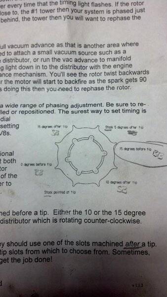

I know Rick E was making adjustable reluctors for the factory Mopar Distributor
I need to drill a old distributor cap and check that out this spring for shits and giggles and see where it’s at
The rotor phasing is really important with a locked distributor and electronic ignition control.
I am using a stock 400 lean burn distributor in the Charger with the FiTech controlling the timing.
I made a cap with hole it it to check rotor phasing, and it was pretty good at idle, then got better as the advance came in.
I am thinking of having a fixture made to drill the reluctor at different offsets for rotor phasing.
I think the FiTech uses 45 degree lead timing, Not sure what the stock leanburn used?
The Sniper uses something like 53 degrees lead timing, so I don't think the stock lean burn dist would work without having the reluctor locating pin hole drilled 8 degrees further (4 degrees at the reluctor/Rotor phasing.
