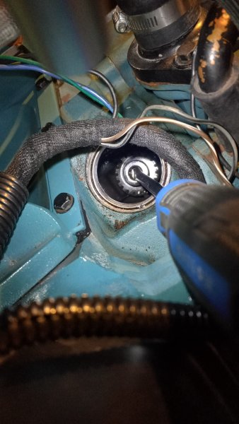

Also had the distributor out and engaged the intermediate shaft. Should be absolutely zero play in between shaft and cam gear ?

Since you have it out that far, check the intermediate shaft for wear where it rides in the bushing.

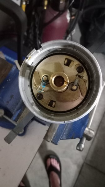

From what I see in the picture the mechanical advance arrangement sure looks like it will retard the timing.
The larger foot shaped piece will swing down and to the right pushing the 2 arms counterclockwise.
Unless I'm mistaken, I think it's the wrong distributor.
Have to point out this distributor has been in the car for about 14 years. I have graphed timing curves with it . To the best of my memory I have never removed the weights , only changes the springs and adjusted the max mechanical advance

I went and added a collar to the bottom of the distributor gear.
