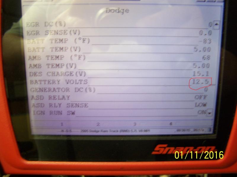

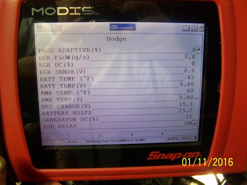

OK, Here is what is happening. I have the Chrysler PCM and stock 6.1 alternator. The PCM is from Bouchillon Performace and has been re flashed by their computer guru to work with my set up. After much ado about the PCM set up, I finally convinced them that the problem is not in my wiring but in the PCM. I sent it back to them and they changed the voltage value in the PCM by lowering it one volt. That is why the scanner tool now reads 12.5 instead of the real battery voltage of 13.5 volts. I have been trying to convince them that they lowered the wrong voltage and should have dropped the desired voltage from 15.1 to 14 volts. Before I sent the PCM back to them, I read actual battery voltage 13.5v at the field wires at the alternator. Now, I read 12.5v at the field wires. I have swapped the field wires because I too thought I was full fielding the alternator but it made no difference. I am now in the process of sending the PCM back to Bouchillon in hopes that they will be able to change the battery voltage back up the one volt and lower the desired voltage by at least a volt. To me, a desired voltage of 15.1 is too high and will cook the battery in short order. Here are a couple of scan screens showing what the computer sees. I am still confused why the desired voltage is 15.1 and when I test voltage at the battery with the engine running, I am reading 15.8 at idle and 16.1 at 2500 rpm on my Fluke meter.

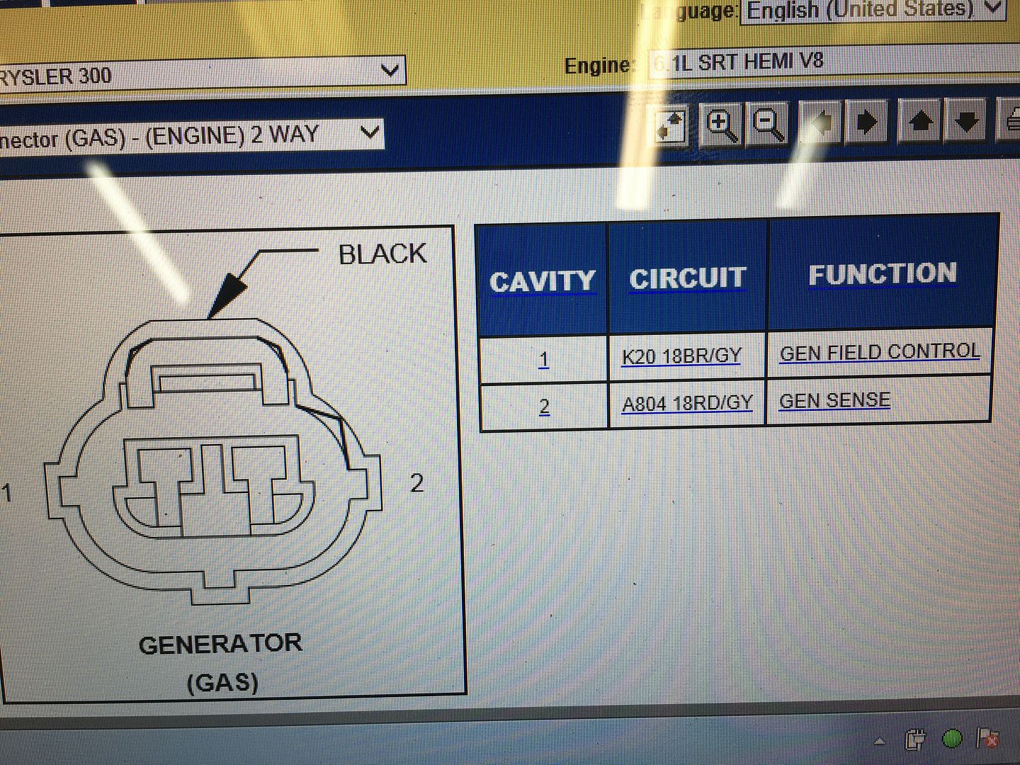

Here is the connector. 1 is field control and should be in PCM connector C2-19. 2 is the voltage sense, and goes to C1-24. Just verify they are not reversed. You need to check voltage at C1-24 at the PCM (back probe) and verify it it the same as what the scan tool displays. As long as the PCM is requesting a desired voltage that high, it is going to make the alternator try and produce it. Most of the LX cars I work on usually requesting a desired voltage of 13.6-14.4. Never seen one asking for that much.
Can't get the connector to show, so just snapped a pic.
Thank you! I wish I would have had that info before I sent my PCM back to Bouchillon. I did know the plug configuration and checked the #1 wire on the plug (green) and it was on C2-19. The black wire on #2 went to ground. When I get it back, I will check at C1-24.

Sure. If #2 went to ground, you had NO voltage sense, which I'm guessing is your problem!
I do have voltage sensing at the plug. I read battery voltage between #1 & #2 with the engine running. I did not check it to ground but I got a diagram from Hotwire. It showed the green wire on #1 going to C2-19 and the black wire on #2 referenced to engine ground. I knew #1 went to C2-19. I verified the green wire was on C2-19. They didn't give me a pin # as to where #2 wire went. Only to engine ground. I have high hopes that Bouchillion will be able to lower the desired voltage threshold to under 14.4 volts in my PCM. Otherwise I will be after them to replace it. Thanks again.

I appreciate all of the responses on this issue. I don't know what the Motorola guy did to fix the voltage problem. I was not aware that PCM monitors battery temperature. I saw in the scanner window that my battery temp was -83F. I disregarded that info as there is no sensor to monitor the battery temp. Maybe that is where the glitch was. I also saw the scanner tool said my AC Hi side was 483 psi when there is no sensor for that either. I have no idea how the PCM gets data where none exists. Maybe I should just stick with the vintage stuff where you only need spark and gas to run.
Many PCM's now have a temp sensor unit in the PCM but many over the years also had a seperate battery tenp sensor. The colder it is the higher the target voltage. Like at 30 degrees it may be as high as 15 volts and at 100 degrees as low as 13.4. Average at normal 70 degree temps is about 14.5. The PCM also moniters the AC high side pressure through a pressure transducer that screws into the AC high side and it just works like a MAP sensor only it changed AC pressure into a voltage reading instead of vacum or boost. Course yours dont have it. The PCM will have 3 wires on the AC sensor as one is a 5 volt feed and one is a ground and the last one is the signal wire that can read from 0 to 5 volts. But when it does not have it the PCM will see 5 volts on the signal and feed wire and it will just set a default code and read a very high or low volt reading as when it see's a constant 5 volts it knows it has an open circuit and will set a voltage high code in that circuit. Ron
Thank you 383man. That explains where the 5v reading comes into play. It also explains why the PCM wanted 15.5 volts with the -83 degrees.
