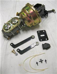

OK this problem has just surfaced on the car my old 440 is in. A while back I installed one of those goofy offset CPP brake boosters on the car. The same one is on the Road Runner and both have crappy brakes but both were fine to start with. I think I know the answer to the question.
I think the crappy brake boosters are failing internally. And a vacuum leak causes the engine to rev when you hit the brakes. This is not the issue with the roadrunner. I think that's just a lack of vacuum since I installed the new cam in that. I won't have the car here until tomorrow to find out what's up with it. Just figured I would post and get opinions. Thanks
The car is a 1971 Plymouth Satellite. Any booster suggestions would be appreciated. I don't like the offset ones at all.
The offending booster is one of these types.

Never had that problem with a Mopar specifically....... But I think that angle fitting that you can barely see in your pic is supposed to be an integrated check valve. If it sticks or fails, it can make the motor rev, and in some cases nearly stall.
***edit*** maybe check valve is the wrong term....maybe more like a restriction or orifice that could come loose or fall into the booster. Either way, every time you hit the brakes, it shoves a ton of air into the intake manifold, temporarily dropping your motor vacuum.

Got the car here yesterday. Pulled the vacuum line off and capped it. Hit the brakes and no idle up of the engine. Put the hose back on the booster and hit the brakes the engine revs up. So its an internal leak on the booster. Contacting Summit for a replacement. Great now I get to replace junk with junk.
Summit is sending me another booster, should have it tomorrow. So we shall see if this is indeed the issue.
The new booster came today and 30 minutes later we have brakes again. Just a pain in the *** to return this crap. But with Summit 60 miles away shipping is next day fast.
