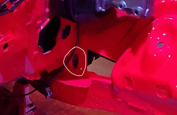

Does anyone know if a body plug goes in the hole I've circled and if so where it might be available from?
Thanks
Chris
Not to my knowledge. The hole it there to tighten/loosen the "Z" bar stud nut on a manual trans car.
thanks 69bee. It's an auto car and I've looked all around the internet for any pic of the hole being plugged and haven't seen one.
no plug there........as stated above, it is a z bar access hole for cars equipped with a manual trans

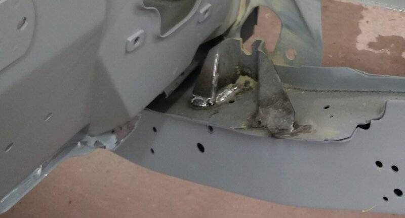

they all have that hole...... manual trans cars have a bracket that holds the z bar welded to the top of the rail

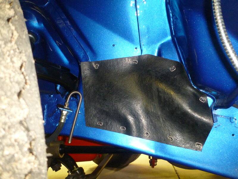

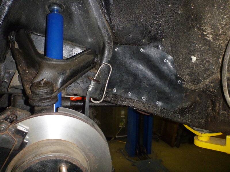

A piece of rubber with push in clips covers that whole area to keep dirt out.
