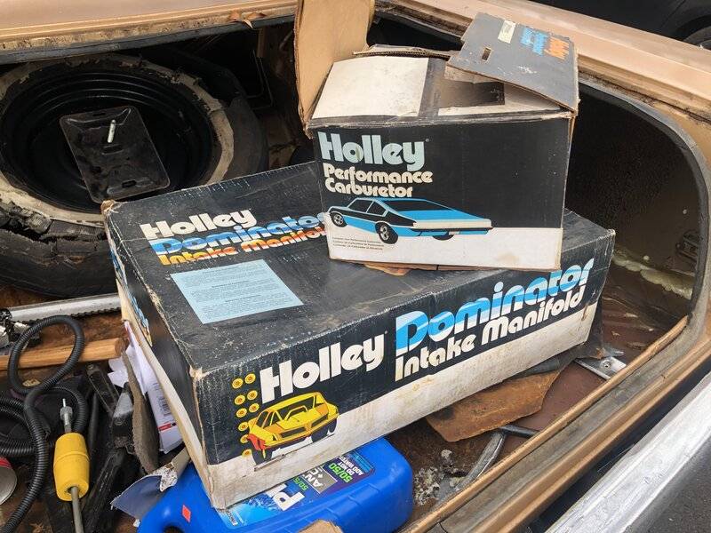

Hey all, I recently picked up a NOS Holley Dominator intake and a 9210 Carb . Both still in the original boxes and probably from the mid '70s as the model years on the instructions stop around '75. Anyway, the carb seems to be running wicked rich and I figure I should re-jet it so I was wondering what was recommended. I already have replaced the seals on it. Also, it has an electric choke, so I was wondering where to connect that. Right to the coil makes sense to me, but I'm not sure. Here's a picture of the stuff-

I'd get a spare tire first. Did you replace the Power Valve?
(sorry, couldn't resist. )
