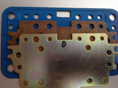

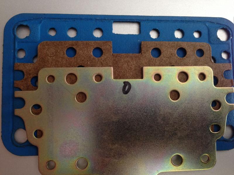

May have found the problem....the photo shows the secondary metering plate gaskets. Note one hole is not punched through although it was "scored". I've ordered new gaskets from Summit ...not going to re-install or punch out the hole. Am thinking of sending it to Holley along with a letter sharing with them this has driven me crazy for over a week...I'll post the results when I receive the new gasket with all the holes open....by the way it connects to the same venturi that's been dribbling.

Glad you got it fixed, although I'm not sure in my mind how too much gasket material caused a dribble...what am I missing?
Look closely at the top left of the brown gasket. The hole is not punched through. These are the passages in the carb, this one is blocked.
Holleys reply which is what was happening with the unpunched hole.

I just read this, saw the blocked hole (good catch, BTW), and thought 'air bleed is blocked'... and that is what Holley says. Makes sense.
BTW, the letter's description of what an air bleed does is not entirely complete; it describes what the air bleed does after shut-off. In operation, the air bleed jet allows air to come into the mixing (or emulsion) tube in the jet body from the top and the main jet feeds fuel in from the bottom. The air and fuel mix and produce an air/fuel emulsion (small fuel droplets suspended in air) and that is pulled through the auxiliary venturis and down the throat. Some carbs have changable emulsion tubes, and air bleed jets as well as main jets (not this one).
An air bleed change will typically cause a need to for a main jet change. So your secondary carb jetting/operation from heavy cruise to WOT will change with this being fixed.
I have seen the clogged air bleed do that before but have not seen the hole in the gasket not punched. It will cause a siphon effect and cause the dripple out of the venturi. Nice that yiou found that because 99% of the time it is a float or needle and seat problem. Ron
