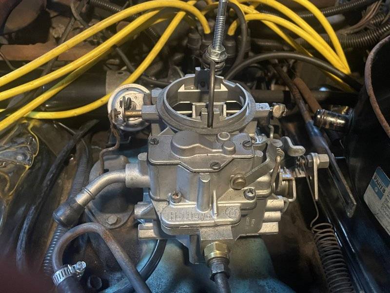

Okay so I’m at my wits end here. I have a 1970 satellite with a 2bbl 318/904 and 8.25 2.73 rear.
Engine is original and I don’t think it’s been apart. I have this issue where when I give anything more that 3/4 throttle it bogs and shakes losing power. Here’s what I’ve done:
Ignition: new dizzy with correct points clearance, new coil, new ballast resistor, new rc12yc plugs (replaced autolites, looked good but #8 was cracked) Timing set at 9 initial and 34 all in. Idles seems best there.
I have all the idle vacuum in the world.
New fuel pump
Holley 2280 with a fresh rebuild. It was “professionally rebuilt” by a shop before i bought it a few months ago. I rebuilt it again and it was clean as a whistle, but some of the clearances were off. I reset the accelerator pump stroke, high idle choke clearance, bowl vent, and fuel float all to 1970 318 mopar specs.
Air bleeds are 1.5 turns out, changing that doesn’t make much of a difference in rpm.
Curb idle is about 650-675 depending on temp.
Yesterday after doing all this, it ran great and the WOT bog was gone. Today it’s back like the problem never left.
Any ideas guys?

Is there a pic posted because I dont see a carb?
