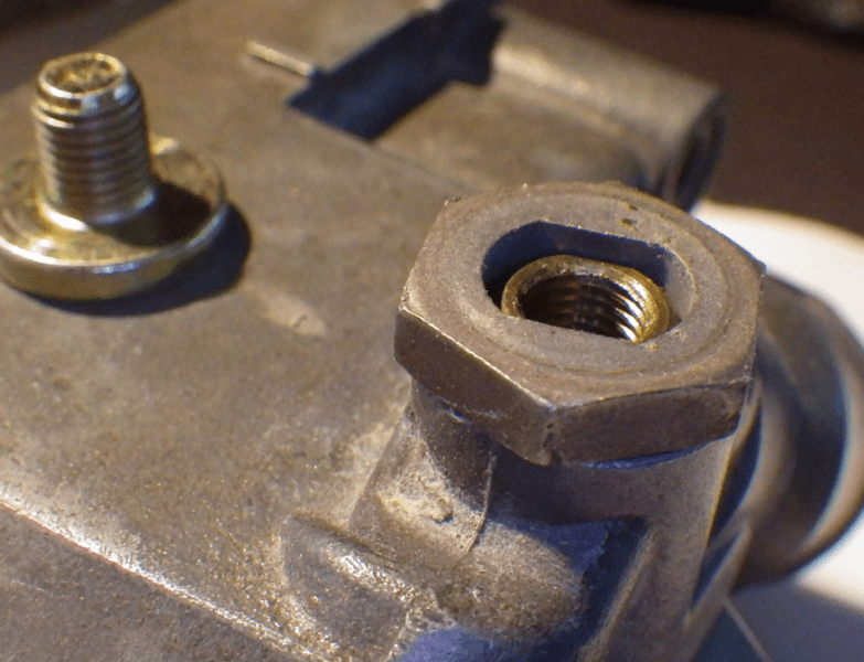

To see exactly where the needle and seat are means I'd have to pull off the float bowl again? If I damaged the needle and seat O Ring when re-assembling, would this cause fuel to be coming up and going out my lock down screw gasket? The only issue I'm having now is the gaskets in the lock down screw/nut weeping fuel, so I was thinking to buy a new lock down nut/screw etc today and try that...

FWIW, this is how I see it.
If the needle and seat is too high and the lock screw bottoms on it, the seal may not seal for you as, others stated here previously.
If it's adjusted really low to meet the sight plug, it may indicate high pump pressure, a failing float, or the needle / float contact point may need adjustment.
The bowl fills from the top. The O-ring seals the fill side of the needle and seat, so fuel is forced through the needle and seat.
In effect, the nut seal and screw seal see pressure constantly while running.
You are just seeing fuel out the screw as I understand it. A damaged O-ring would tend to flood the bowl.
IMO, a damaged screw / nut is most likely the only issue you have.
Way out of the box, maybe the internal threads of the needle and seat are not square causing the screw to not seat flat.

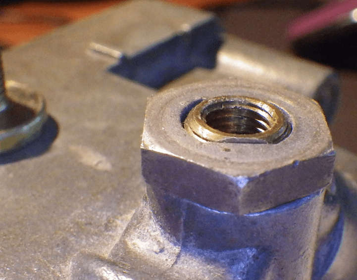

Yes... All makes sense.. I just replaced the needle and seat to be sure, and for the record, it sits approx 3mm out of the float bowl, so that is all good I believe.
I just drove it about 15 miles and the gasket from screw to adjustment but is still getting wet... So I will now go and get/replace the nut/screw and gaskets ; albeit I can't do t for a few days as the vehicle is at the body repair shop for a repair... Also, I have inspected bestbi can to ensure the screw is seating/screwing down flat/square, and it appears to be, but let's see what happens with new hardware... Fingers crossed, thanks everyone for your very kind and helpful assistance on this !
Update... I made another gasket out of .6mm gasket paper, it initially weeped slightly, but after leaving it for a few hours it has dried up!... So now I'm leaving it overnight and will re- test in the morning to see what happens when I fire it up again, as it seemed as though my float level was slowly dropping (it's steady now at around 30% full), as per pic, so I may need to readjust again to sit around halfway up the glass (I fear this may disturb my nice dry gasket tho View attachment 1629711

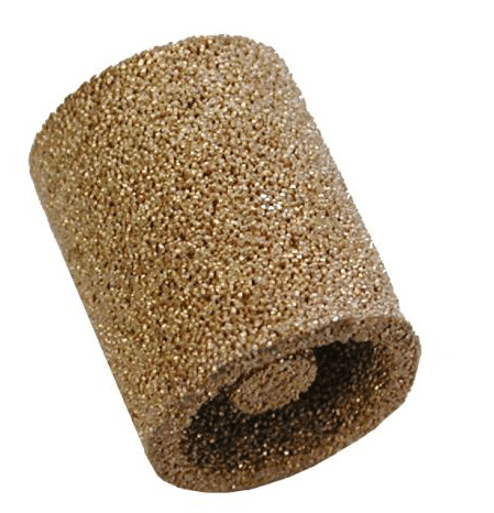

Are you using the bowl filters? Is anyone?

I have those metal filters in all 3 carbs. Chicago carburetor carries the kit or individually.

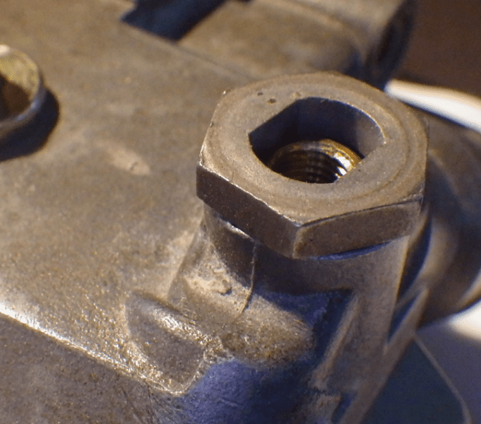

Concerning your leaky needle and seat, are you tightening it enough? I don't remember ever having this issue. Or is the top thread in the bowl/ needle and seat pulled up a hair?
Sorry, what exactly do you mean by "pulled up"?

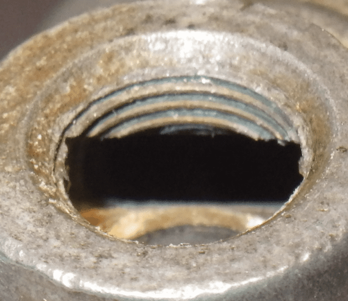

Have you checked the metering block and body face for flatness and/or cracks?

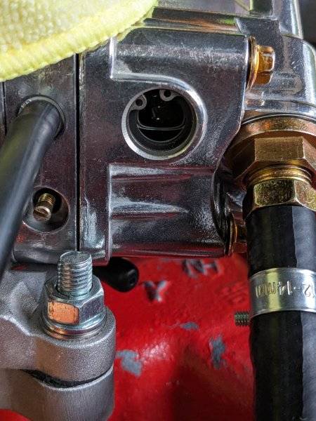

Update... So I've had the carb sitting on the bench all afternoon with fuel in the bowl as per the pic below, and it's not leaked a milliliter... I disassembled the Metering block/ Power Valve assembly and reassembled, carefully inspecting everything best I could... wondering if the Carb needs to be hooked up to "pressure" , and/or have gone through engine running cycles to test properly also, do I need the needle and seat properly fitted to test it etc? Am I missing something here!?!?
