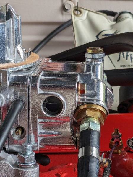

However, meanwhile I went ahead and purchased a new one from my local supplier here in Oz to keep me going. Have been dialing in last few days and she runs well. Last night when I parked it up I took a pic of the float level, then a comparative pic this morning showing the difference... Please see pics attached, ...I am just wanting to ascertain if this slight drop overnight is normal/acceptable? (Perhaps, due to normal evaporation etc?)... I am super paranoid at this point in time (I have approx 20k AUD invested in my engine build and keep thinking I'm smelling gas in every oil change!). ; I am tempted to remove the Carb later today to check if my intake is wet? Should my intake be bone dry when I remove the Carb? The next thing I could check is if fuel is entering the crankcase via the new fuel pump(highly unlikely, but hey

Pics of float level I forgot to attach to previous post! As you can see , not a lot of difference but still some fuel has dropped/ evaporated?

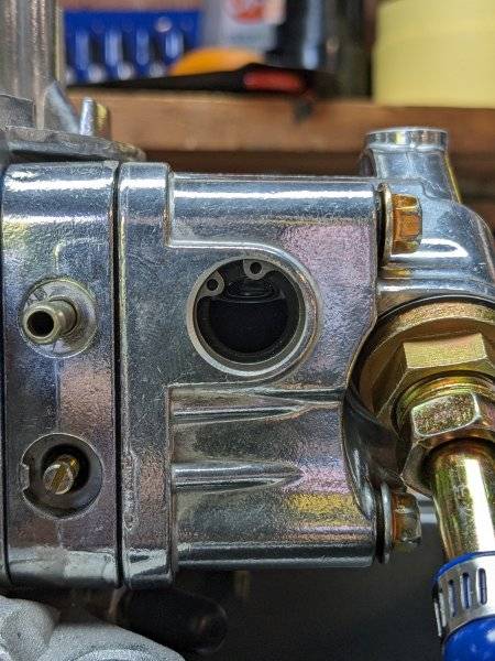

Update... So I've had the carb sitting on the bench all afternoon with fuel in the bowl as per the pic below, and it's not leaked a milliliter... I disassembled the Metering block/ Power Valve assembly and reassembled, carefully inspecting everything best I could... wondering if the Carb needs to be hooked up to "pressure" , and/or have gone through engine running cycles to test properly also, do I need the needle and seat properly fitted to test it etc? Am I missing something here!?!?
Only thing I'd picky of is the fuel level, IF thats what my aging eyes see? It should just only spill out when car is nudged hard from R fender. I'm not "Thee Expert", just an observation.. Never seen a Snap Ring inside the sight plug hole. Ya know it didnt occur until daya later to me, BUT do you have BRASS floats or the plastic type? If theyre BRASS they can leak allowing gas inside em. And NOT rise to shut gas off. You should be good.
Sorry this is all irrelevant as I have sight GLASS not plug, thanks...

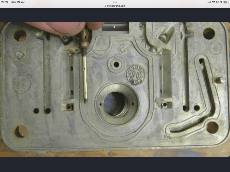

Hi!
I made zero progresss with my carburator.
I did lube the powervalve gasket, because the stamp on the meteringblock is interfearing with the gasket surface.
adding a borrowed picture wich is simillar to my meteringblock.
I thought, maybe that stamp was tearing the gasket when installing powervalve.
This seems not to be the case since my carbutator stil leaks fuel into intakemanifold, 1 / 3 of the fuelbowl is gone in one week.

That stamp ridge (from what I believe) should not adversely affect the sealing quality of the gasket. For the record, on (2nd, replacement) carb, my bowl empties out almost entirely over the course of a week. However (can't remember if I've already mentioned this), I spoke to another carb expert who assured me that the modern type fuels/gas evaporate this much, so it's nothing to be concerned about necessarily;I am having my oil tested for fuel contamination though, to be sure.
I assume you're pv gasket is soaking wet when you inspect it? Another option is to try sealing the PV with a Viton material O Ring... Apparently this can be a suitable fix for a stubborn leaky gasket scenario... You need to have one that is firmish against the ID of the PV where the gasket would sit from what I can tell and there is a video about it on YouTube if you do a search.
Failing that you might have to replace major components like I did
Possible you just have a faulty metering block leaching your fuel without pressure. I think I'd try red dye in mineral spirits to verify.
