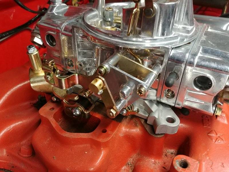

Holley carb on my spread bore 440 manifold.

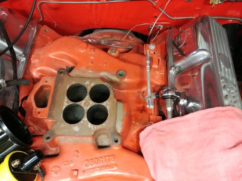

that doesn't look like a spread-bore/Themoquad
small primary & large secondary manifold
looks like a square bore, both bores are the same size

Agreed, looks like a square bore to me. Mine was waaaaay different with clearly noticeable size differences. You might want to find a gasket that fits the carb then lay it on the intake and compare because it looks like that Holley should bolt right on.
Also I noticed a large machine gasket surface on the left, sit your Holley on there and make sure none of the linkage hits that surface preventing it from sealing.
I am learning a lot putting the gtx together. I enjoy restoring parts but am learning the mechanical as I go along. The manifold could be a spread bore as you say but I still have clearance issues. I believe it is the sec pump cam that is hitting the manifold.
Meant to say square bore as you say. I did not think it was a square bore because of the 4 round bores.

View attachment 733287 I am learning a lot putting the gtx together. I enjoy restoring parts but am learning the mechanical as I go along. The manifold could be a spread bore as you say but I still have clearance issues. I believe it is the sec pump cam that is hitting the manifold.
(Meant to say square bore as you say. I did not think it was a square bore because of the 4 round bores.)
Again "spread bore" refers to 2 small primary throttle bore with 2 MUCH larger secondary bores. I forgot about the linkage interference problem. A 1/2" spacer/adapter takes care of that. The '70 manifold should have the correct carb mounting bolt pattern. As said, use the Holley gasket to verify both carb & manifold bolt patterns match, turn 90* to be sure.
