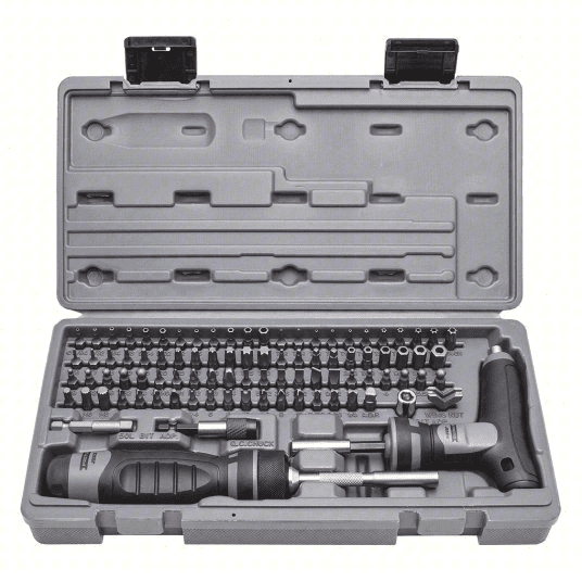

Sometimes they come in those kits with a hundred different bits.. but I just modify an old flat blade to fit

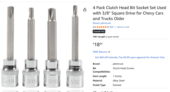

Clutch head is what you need as mentioned. Don’t know where to buy. I think I bought mine from Snap-On like 40 years ago.
They sell clutch drive bits you can put in your screwdriver.
There are several sizes out there so have a sample screw with you.
Snap on tool truck is a great source.
Got mine at Menards in a magnetic screw driver and bits as a set. I’ll go out and manufactures name

I made an order for this:

I found it!
5/32 clutchhead if memory is correct on size. I've had a driver just for that since the mid 70's. Still need it sometimes.
