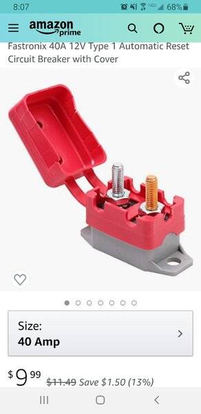

For a Spal fan, they pull a lot of amps at startup and about 25amps constant. I have run dual Spals before and will only use 10 ga wire from battery to #30 and from #87 to fan. I have used a 40 amp fuse on battery hot but changed to a 40 amp breaker. I changed because my fuses didn't blow, but the plastic would melt. The amperage creats heat.
This is what I used so leads were covered.
