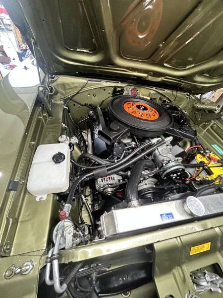

I wanted to share some thoughts and opinions I had in adding the Sniper EFI to my 71 Charger. At the time, I couldn't find information on some of this setup. I hope this information helps someone to do a better/quicker job than me. Let me know if you have questions/suggestions.
Car: '71 Charger w 383, stroked and bored to 413 w 270 Comp Cam. Tremek 5 speed and 3.91 gears in 8 3/4" rear.
Holley Sniper Installation instructions: Read them and follow the recommendations. Read them and follow the recommendations. Read them and follow the recommendations. :)
Timing: When used w the Holley distributor, the Sniper controls the timing (SNE 550-511K, SNE 550-305. I used the Holley Coil Driver - not MSD box). You set the timing you want for Crank, Idle, Wide Open Throttle and Cruise. On a car w a stock distributor, you have to set the initial timing, then choose weights and springs and adjust the vacuum advance to guess what the final timing might be - according to engine knock. Once the Sniper is set to the engine everything else is a number you set on the Hand Held. (My car loves idle timing @ 20, but I have crank set to 0 and total at 34.)
Gas: The Sniper has a closed loop calculation w the oxygen sensor in the exhaust - it sends gas accordingly. It learns and adjusts to your driving habits and drive conditions. Carburetors work great, out of the box, but then you have to adjust metering rods and/or jets and accelerator cam(s). To do this properly you'll need to monitor AFR in a variety of conditions . . . and adjust accordingly. (I have AFR's set to 13.5 at idle, 14 at cruise and 12.5 at Wide Open - recommended numbers from the Holley Instructions. ) Initially - I tried to reuse the gas tank and use an external pump, the used/original tank clogged the fuel filters. I replaced the tank with one that has an internal pump (AEI 18162). Run new lines.
Cooling: The Sniper can control 2 electric fans (This one has 2 speeds: DER-16217) . . . That turn on when needed.
Electrical: Electric fuel pump, electric fans. If making additional changes/additions upgrade the altinator. (140 amp on CVF serpentine)
'The Pink Wire': Sniper needs the Pink wire to have clean power during Run and Crank key positions. If you've got the Holley distributor - you don't need the ballast resistor, but the power wires to the resistor are Run and Crank. Originally I attached them w a diode to prevent any current going the wrong way, but there ended up being a flat spot between the run and crank in that key position that disrupted the Sniper computer. I added a 'Delay Relay' to this circuit. (74985 www.delcity.net ) The delay relay triggers on the Run wire and keeps the pink wire energized for a (user) specified time through the time of crank. This solved the crank/start problem, but also allows the cooling fans to run after I turn the car off. (up to 3 minutes)
Misc: 'Throttle Extension' Summit SNE 20-16 drastically improved the ease of throttle pressure. (The aftermarket linkage that makes the Sniper secondaries work separately than the primaries was discouraged from Holley Tech.)
Misc: This throttle cable bracket worked great (Mancini MREAR134S ) . . . was worth the money. It held the throttle cable and gave room behind the Sniper to wrap the misc cables and Coil Driver.
Misc: I installed the Sniper over top of a 1" spacer . . . I found recomendations to do this, and didn't want to re-do anything afterwards.
I hope this helps.
Greg

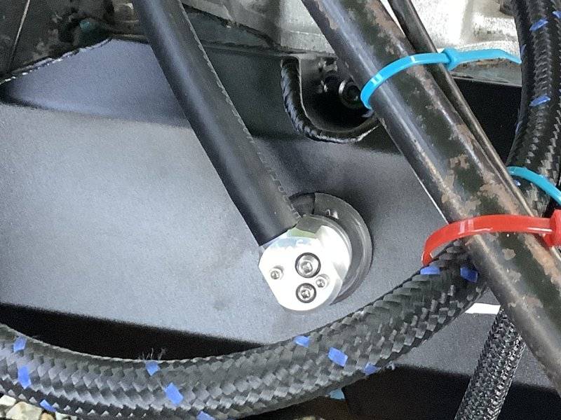

Hate to say it but using the related components as intended is the most efficient route, especially the ignition. Yes, it's more expensive to invest in all this stuff at one time but if you get far enough into it you'll realize that doing it any other way is a mistake.
