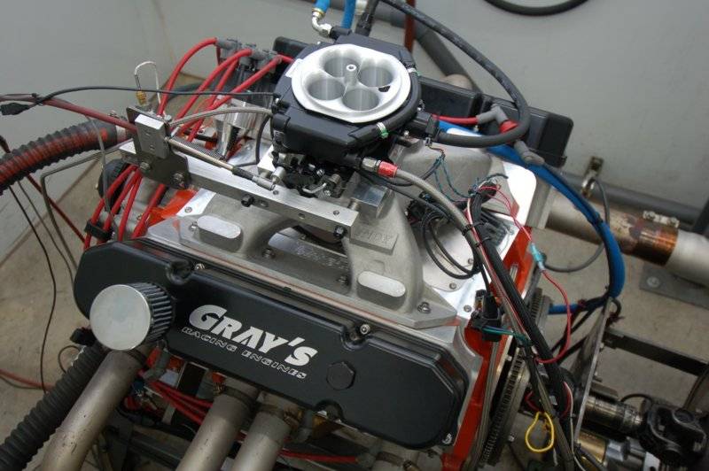

Just ran one of the new Sniper Xflows today. Engine is a 505 inch big block with Trick Flow 270 heads, a Comp solid roller and a ported Indy 440-2 intake. Engine runs on pump gas and made right at 700 hp. The new Xflow is 900 cfm and has 120 lb injectors. The regular Sniper is rated for 650 hp and can't quite support an engine like this. We tried a regular Sniper on this engine and it fell flat up top but Xflow pulled hard all the way.

Good info Andy.
Is that a stock production block or?
If it's a stock block, what are you using, if anything, to enhance its durability?

Stock block. Nothing special required for the block to make them live. ARP main studs and careful machine work is all it takes.
600 hp with 650 torque is easy to do with a stroked big block. We build those all the time. 505 with TF 240 heads, a modest hyd roller cam and a ported intake is all it takes. The Sniper 650 will handle that engine or use the Xflow if you want a little more safety margin. The Xflow is only another $100 so it seems like the smart choice to me.
