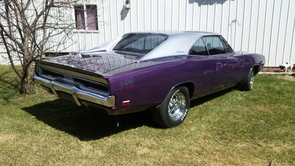

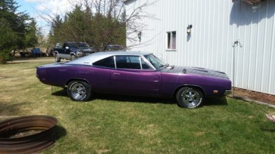

Hi all, I put a holley sniper on Russtoy, my 69 Charger with a 512 stroker, hughes 232/236 cam, cast 452 ported heads, 727 trans, 2000 stall convert, 356 gears. It runs fine but is down on power compared to the 750 eddy that was on it, I know the 750 was too small, so this holley set up should have been better. My air fuel ratio is 13.8 at idle, 14.9 at cruise and 12.5 at WOT. I just set these AFR and it is better but not as strong. I bought the full holley kit with pump and return line,ect. Anyone have any thoughts? The changes I made did improve the mileage for 6 to 10, I know my mileage will be down from my 383, I get that but it should be way faster. I have a little speed trap on my road, with my 383 I could get 87 mph, with the big 512 I can only get 80 The only changes are engine and converter.
