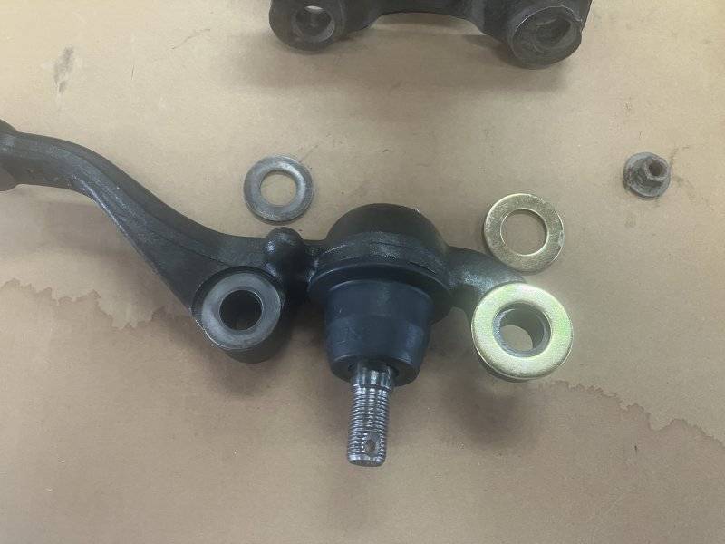

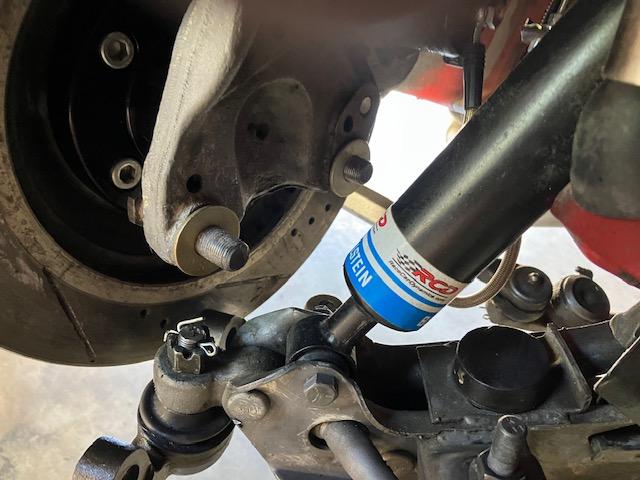

Unless.....You start off with this:
Use a washer between the lower ball joint and the knuckle/spindle. This tilts the bottom out while adding negative camber.
Now, you already have a bit of negative camber to work with.

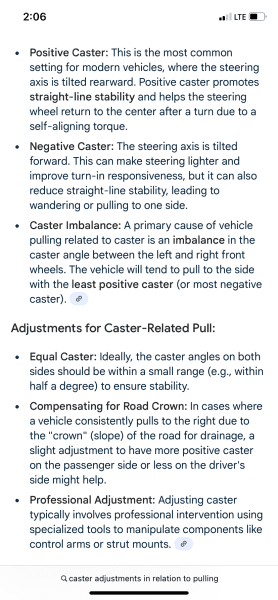

I stand corrected, I was in error about caster
Here's a good way to remember it
Pulls to least  ca ster
Or  most ca mber.
Or  most ca mber.
