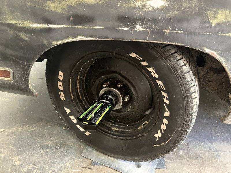

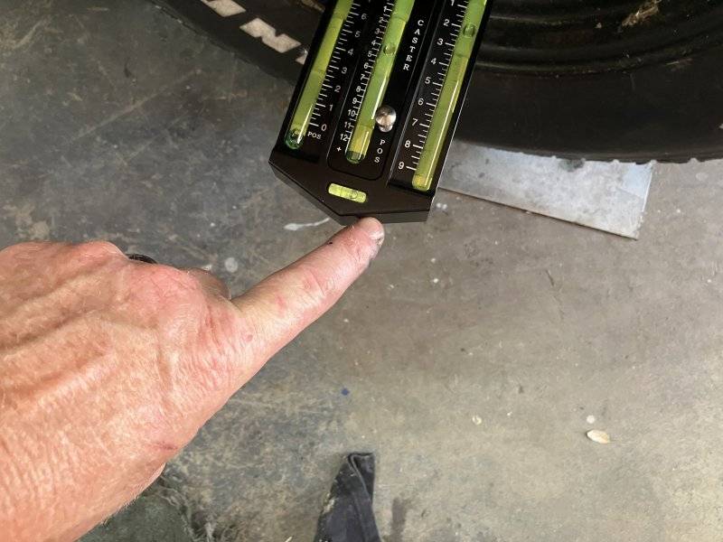

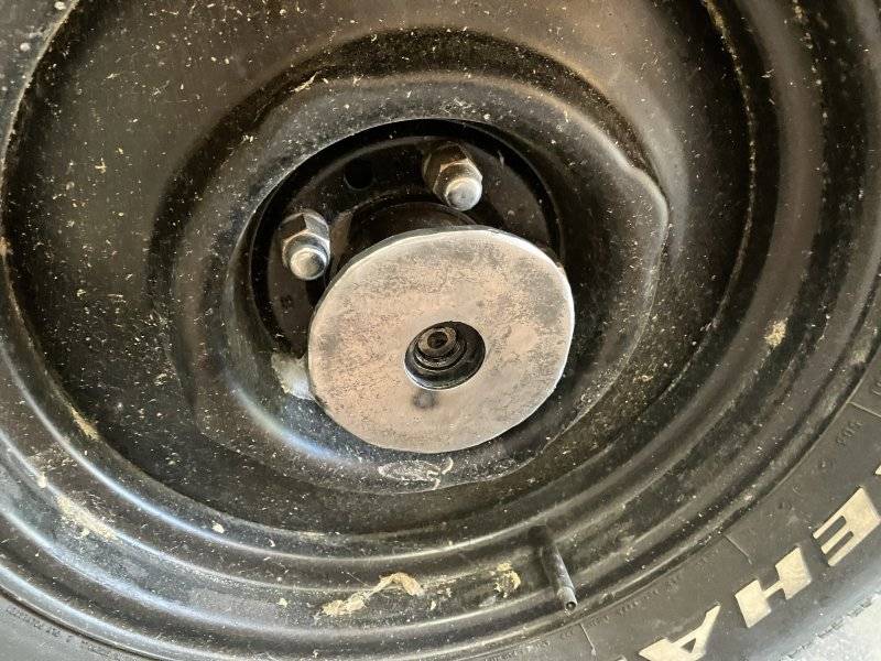

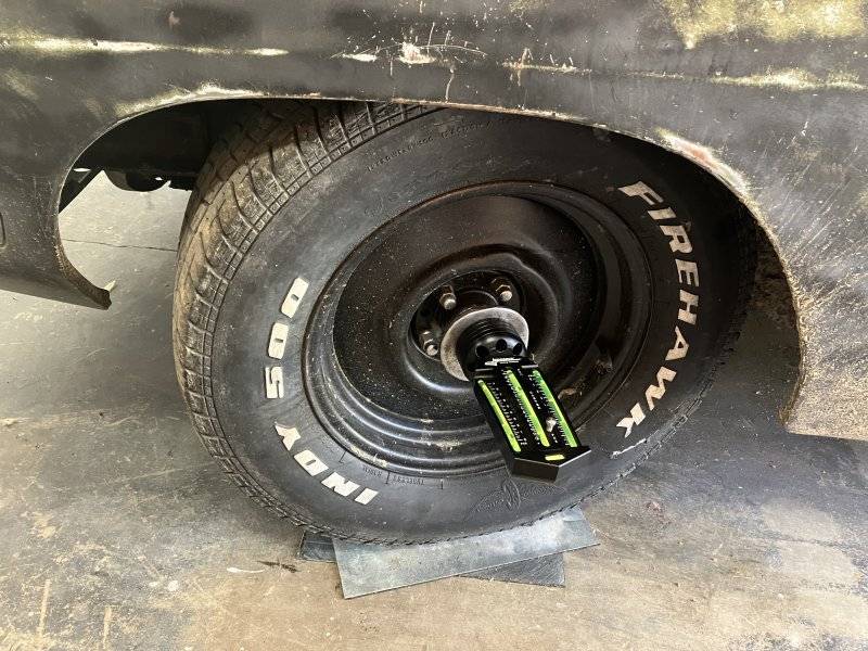

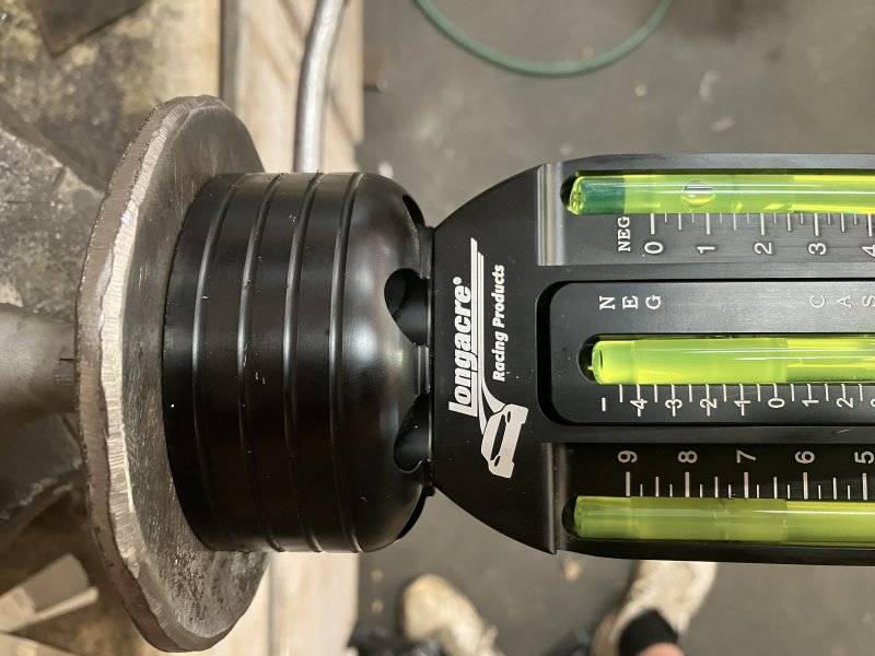

Just on the right side.
When I first measured the right side after aiming for maximum caster, I got a great number but resulted in too little negative camber.
The front cam bolt was out all the way, the rear was in all the way. I was at the limit of adjustment. Adding negative camber through the use of the spacers was a cheap fix.
