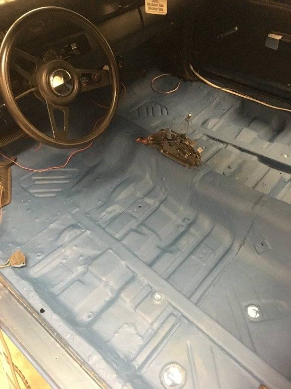

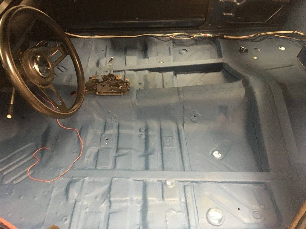

You are going to apply all that water based product to your floor pans? I would be very hesitant to do that. If there are any cracks, unpainted spots (invisible to the naked eye) or gaps near seams or any openings that allow that water based paint to contact raw metal, you are going to start the oxidation process = rust. Think of tiny bubbles in a paint job that occurs over time. That is your sheet metal rusting. If you want to do the lizard skin process, I would go to a solvent based paint that will not cause rust. Might be a little harder to apply and smell more, but you will eliminate a potentially major problem. If you don't want to use a solvent base, then at least use a water-based DTM ( Direct-to-metal), which has rust inhibitors. Just my opinion. For the record, I have been selling paint for 40 years.
a light coat of epoxy primer will rust proof any bare metal and work as an awesome adhesion promoter....... i did a whole lizard skin thread about a month ago...... I also brushed/dribbled por15 into all the seams and seam sealed prior to application
http://www.forbbodiesonly.com/moparforum/threads/lizard-skin.129875/
