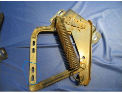

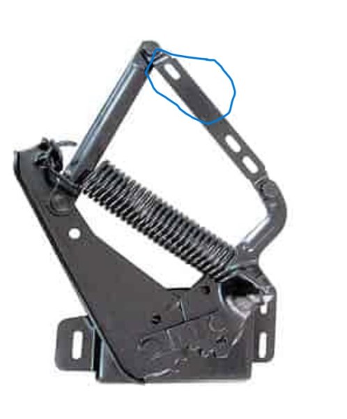

Well I think I found the issue.
Even though AMD lists these hinges as fitting a 66....
The new hinges were an exact match measurement wise.
However they are missing a slot for screw that holds the nut plate in and sticks out of the side of the hood; that I didn't notice the other night.
Old hinges back on for now. Hood lined right up. They arent that bad, just one side sticks up after driving awhile, it gets annoying.
From what I can see they got rid of the 4th slot in 1968. The only hinges made new are the "3 slot" style. AMD needs to update their listing.
I reckon when I get time I'll cut a slot in the new ones so I can use them.
See below.
As a side note, many of the 70s pickups used the same hinges (like the second one in your post). I had pulled a few good pairs from a yard here but gave them all away a few years ago. Use the desired spring and the only difference is that single slot...
