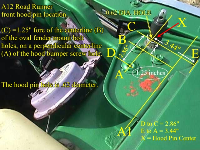

Multiple posts recently on this same question . . . one posted the following link . . .
http://a12mopar.com/yabb/YaBB.pl?num=1198528150/13#13
And here's the figure . . .
Good luck with your install !

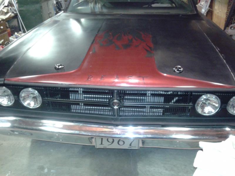

What he said. although the hole will actually need to be a little farther back because of the angle the hood closes. Start with small bits. I had to use a burr bit on a die grinder to oblong the holes in the hood brace because of that. You can always take a rubber mallet and coax the pins in the right location after they are tightened if needed.20141124_175341.jpg
