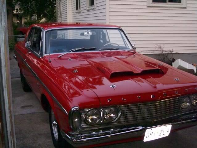

On my 63 Sport Fury I got a deal on this glass race hood so I bought it. Its a light hood so its not a street hood. I use 2 pins in the front and 3 across the back with 2 in the center on the sides. You cant see the one in the center in the rear behind the scoop in this pic. My brother uses a pin in the center on the front of his 64 Fury's glass hood but I only use one on each side up front as I dont need one in the middle. I have no hood lift in the middle and I trap about 125 mph at 10.70's and have no hood lift with the seven pins I use. Ron

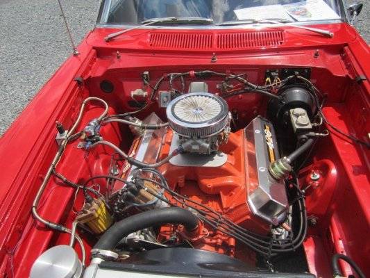

You can atleast see the 3 back pins and where they are in this pic without the hood. Cant see the front and only one of the side pins but I hope it helps you. I think your 65 would be about the same. Ron
