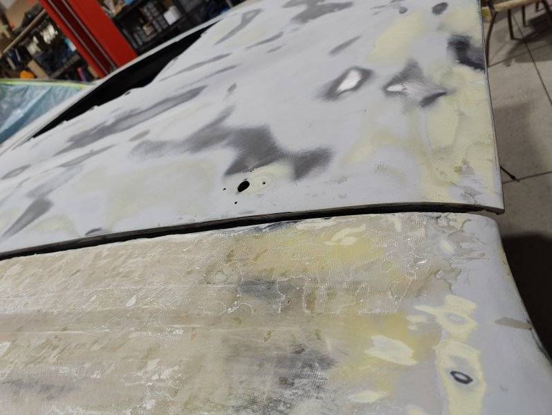

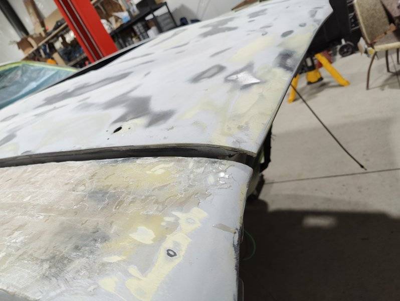

I'm having trouble where the hood spring it's tilting the hood because of the tension.
When I remove it the hood sits perfect.
Is there a way to reduce the tension on the spring? Maybe the spring I have is to long?

I tried that. The left side still stays up and then the right side ends up a bit too trying to adjust both sides. Just curious if I need to cut the spring? Its a new spring and has alot of tension.
Get an original spring and toss that “new” one.
does the latch need to be adjusted down? How could it raise the front if the latch os adjusted correctly?
Sounds like a problem with the hood hinge adjustments

don't worry how it sits on the spring, unless the spring is just wrong and keeps the latch from closing....... get rid of the latch and the spring, rest it on the stops, the stops should be very close to equal or you have another issue

But if it's on the center of the hood, and the hoods going crooked...
The spring doesn't sit center it sits to the left. If it was in the center that would help alot.

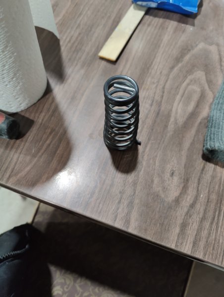

What do you mean why the spring isn't cone shaped.
Mine looks similar to the attached picture. My only next guess is maybe my hood hinge springs are worn out?
The one of the table doesn't look like the one above.

Evenness on the hinge mounting and your hood latch center the hood. The rubber bumpers keep the paint from chipping and the gaps fairly even. The hood pop spring is just that....
The hood spring should be kind of cone shaped. I would try to find an original spring, QC on most offshore parts is crap…
I agree with R413 , adjust the latch down so it holds the hood tight on the rubber stops or your hood is going to flap around while driving until it works the latch loose and folds over your windshield
The hood latch is all the way down. The spring is coned similar to the picture. It's just a bad picture but it's coned
