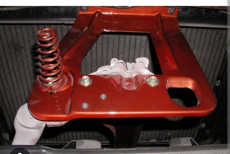

Mine looks similar to the attached picture. My only next guess is maybe my hood hinge springs are worn out?
The one of the table doesn't look like the one above.

The hood spring should be kind of cone shaped. I would try to find an original spring, QC on most offshore parts is crap…

The hood latch is all the way down. The spring is coned similar to the picture. It's just a bad picture but it's coned
