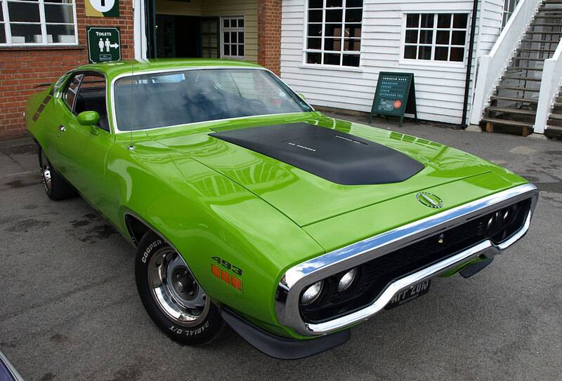

Hello im trying to find out if a 71 -72 road runner hood will interchange to a 73 satalite?

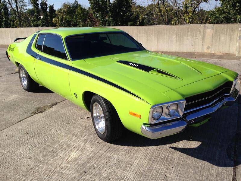

I think just looking at pictures the answer is there:It will fit but doesn't line up with the header panel. 71-2 is flat across the front and 73-4 isn't.
I put a 73 RR hood on my 72 Satellite SP. Just the two front corners were a little higher on the hood then on the Cowl. I made two small Pieces that I bonded on the cowl and customized them to flow with the two raised corners of the hood. Looked like the hood was made for the car. Worked great.Hello im trying to find out if a 71 -72 road runner hood will interchange to a 73 satalite?
