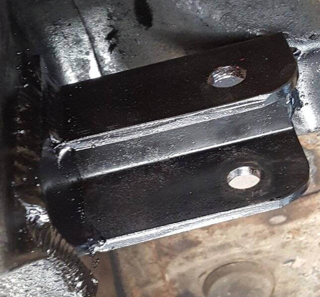

Here is the upper mount we fabbed. It's hard to get good pics up in there. The shocks aren't straight vertical but as close as we could come within the confines of fhe stock chassis.
Thank you very nice work. You said that right room is not all that in the upper location.
