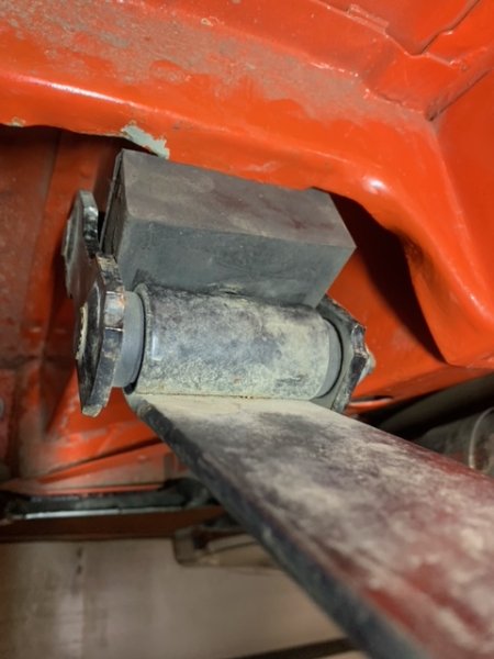

Sorry but no pictures available however I can post a picture of the solution.

If my Cousin's solution solves the problem without making the car unsafe to drive I don't see what your problem is.
