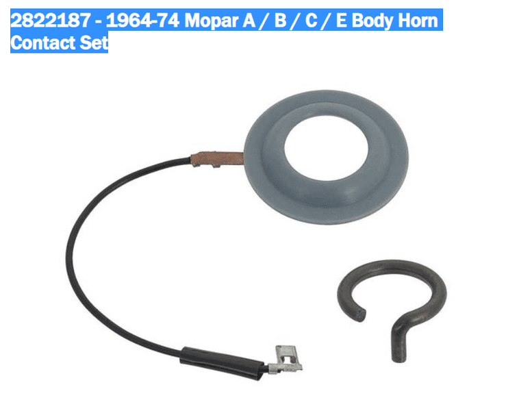

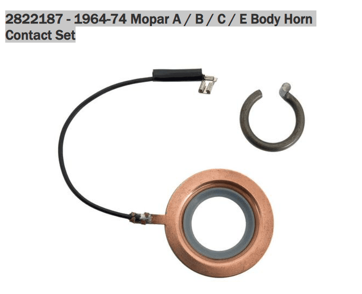

Here is the new part frome Classic Industries.
https://www.classicindustries.com/product/all-years/dodge/a100truck/parts/2822187.html

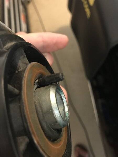

Took the steering wheel off, pulled that horn contact ring off and that tan/grayish insulator ring just crumbled apart. Finally gives me a reason to buy a new steering wheel since the original is all cracked and a turd. Hard to tell if the cracks are natural or somebody took a hacksaw to it.

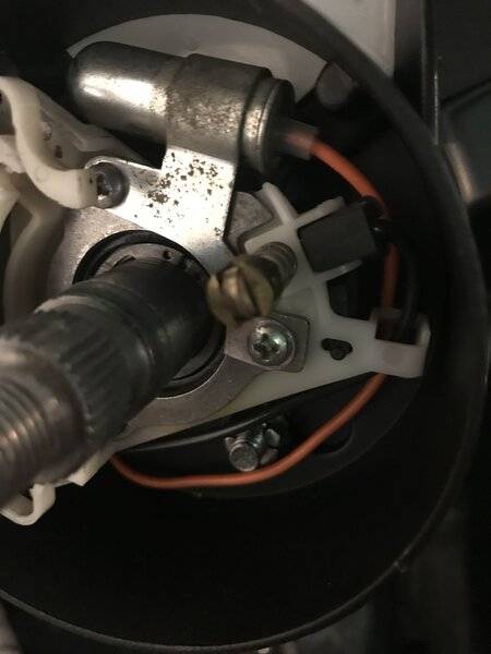

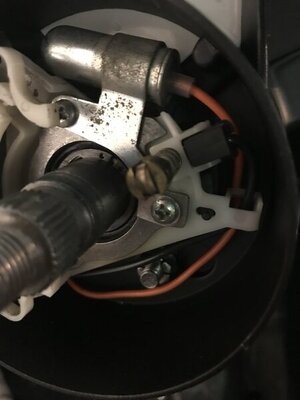

So think I found the issue, whatever this brass post is in the steering column. If I touch it with a screwdriver and the column shaft, the horn beeps. Wonder if it’s out too far? Wrap it with electrical tape? The horn contact locking ring must be hitting it when I turn the wheel.
99% sure that was issue. I was able to look inside the column as I turned the steering wheel, and the horn would beep the instant that locking ring post would meet that brass post. Perhaps in the column restoration process or when it was shipped back to me that brass post was bent slightly inward instead of being straight up. But in any event, heat shrinking that post fixed the beeping horn when turning the wheel, and the horn still works when I press it at my will.
I don't think that is your problem. That rod you put the wrap on is for the turn signal switch cancel feature. Shouldn't have anything to do with the horn.
